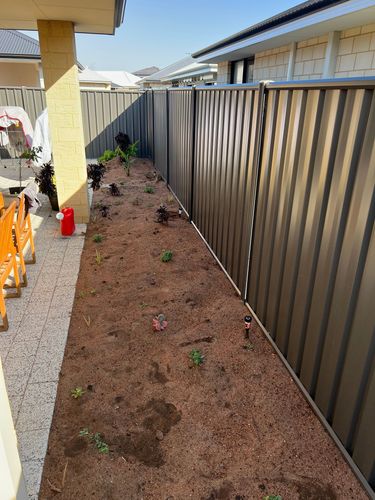

Hi There,
my water pressure from my garden tap is too low for my irrigation.  I
I’m considering to purchase a water pressure booster pump to connect to my garden tap.
could you advise what type should I buy?

Can you please tell us about your irrigation set-up perhaps we can offer other suggestions? How big is your irrigation set and what type of sprinklers have you attached to the pipe work?
