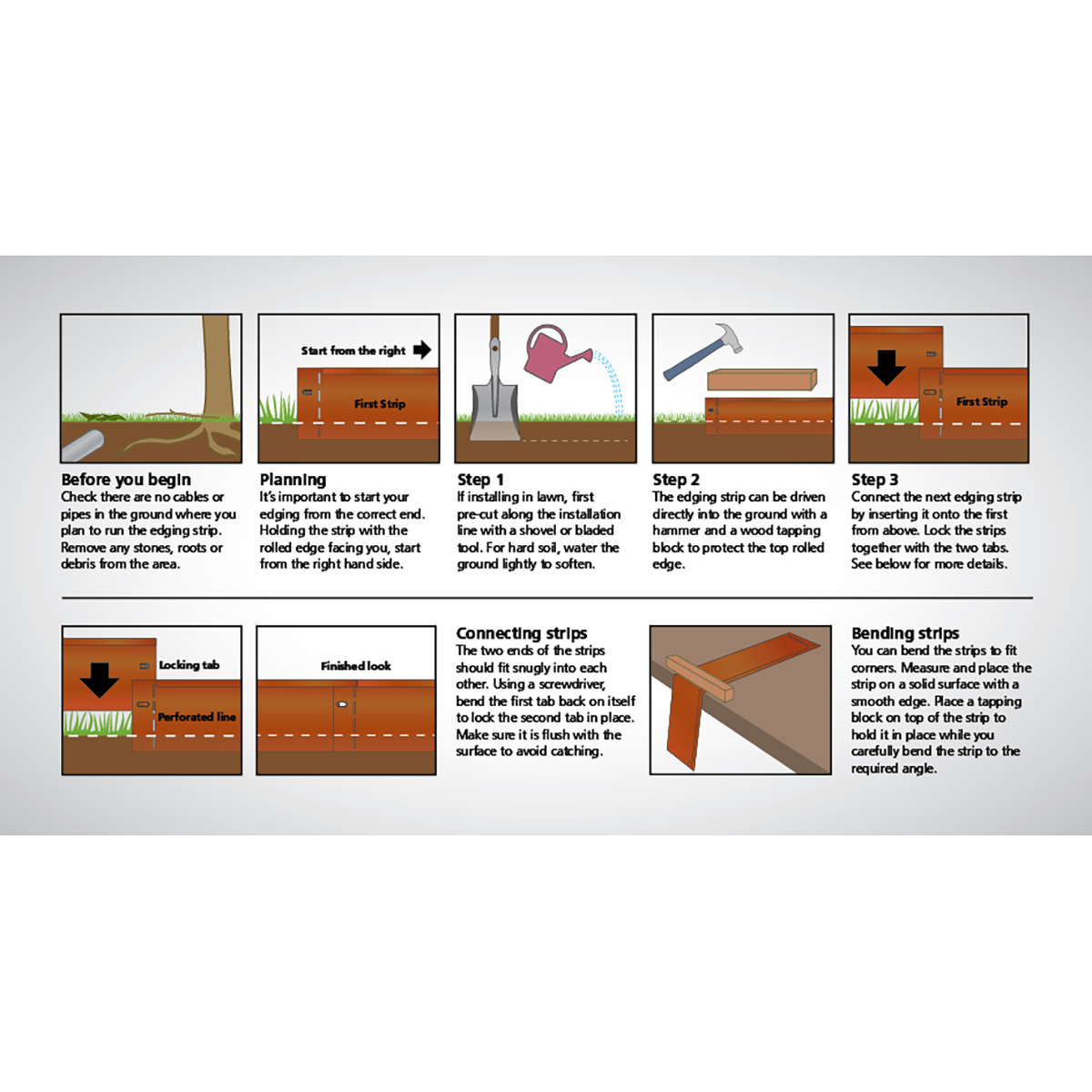

with this product   Jack 1180mm x 200 mm garden edge strip
the sections clip together i beleive - should you also install for extra stability - Jack 300 x 80 mm oxy-shield edging stake and at what distance?
also does the product bend - to do corners and curves?

Thank you for your question about installing the Jack 1180mm x 200mm Garden Edging Strips.
The installation guide shows this product being driven into the ground using a hammer and a timber block to prevent damage to the edging strip, however, I suggest it would be a good idea to add Jack 300 x 80mm Oxy-Shield Edging Stakes over each join for added strength and to give everything a clean, uniform look.
This product will easily bend to a light curve and can be bent to sharper angles using the instructions in the above mentioned installation guide.
