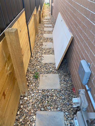

Hi Community,
I want to install a colorbond fence gate.
I have managed to learn to put together a gate with rails stiles and Infilsheet.
I want to find out what post should I use and hang the gate.
my gate will be installed after the gas meter.

As an alternative have you considered using a Wilmaplex Gate or perhaps Fortress Gate Systems. You can attach a Colorbond panel onto the Fortress Gate System and it would be a much easier option when building a gate. Another option would be to use Merbau Gate Panels. These timber gates are pre-oiled and easy to install, plus, look stylish in any setting.
In regards to the post, I suggest using Protector Aluminium posts. They can be anchored into the wall or buried in the soil. It all depends on the height that you are after.
Thank you for your patience.
Hello @usmanjawaid
Thank you for patience, I've spoken to the Colorbond technical department. I suggest measuring the opening of your walkway from wall to fence. Once you have that information, I suggest going to your local store and speaking to a special orders team member and asking them about making a Colorbond gate kit quote from Lysaght.
The gate comes in a few sizes so the measurements you took will come in handy. The special orders team will also be able to recommend the post you'll need for your gate.
