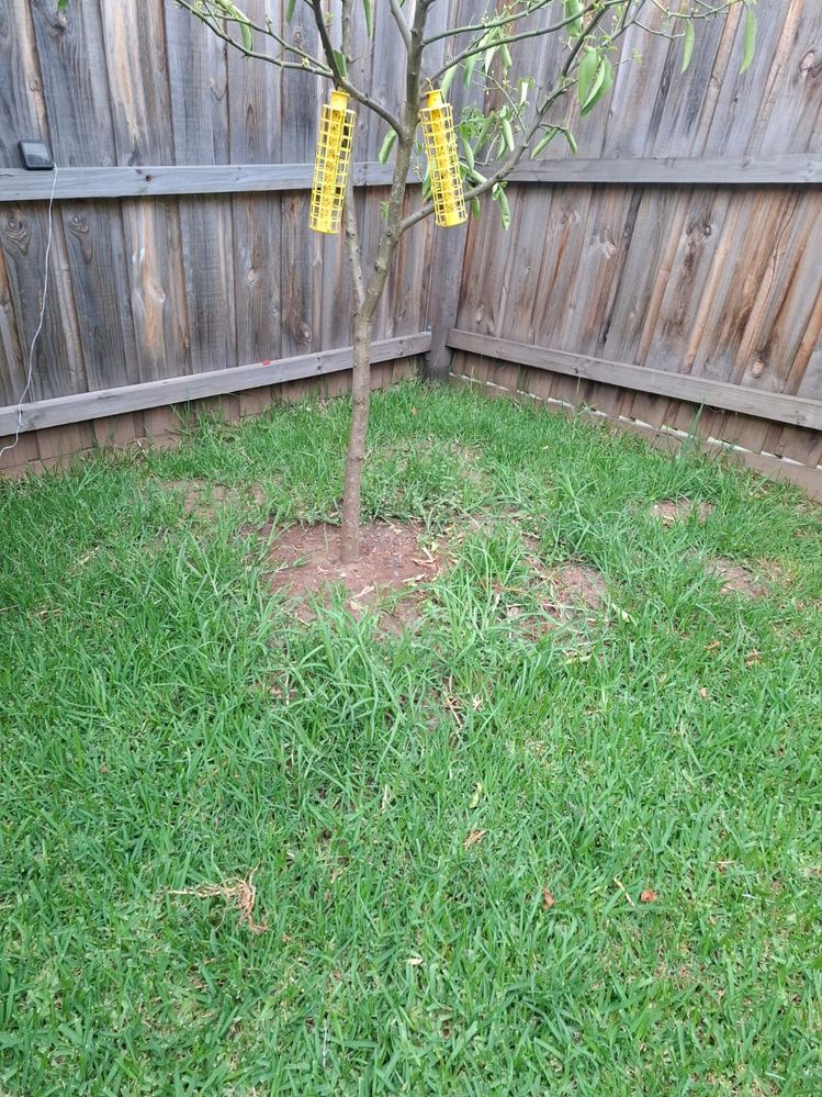

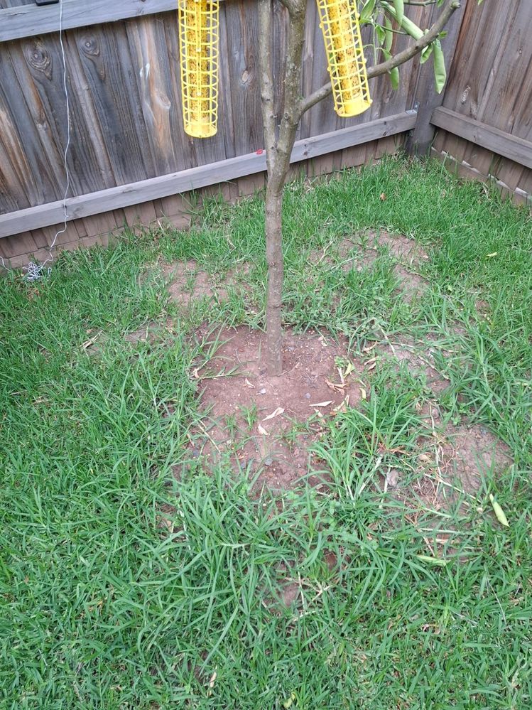

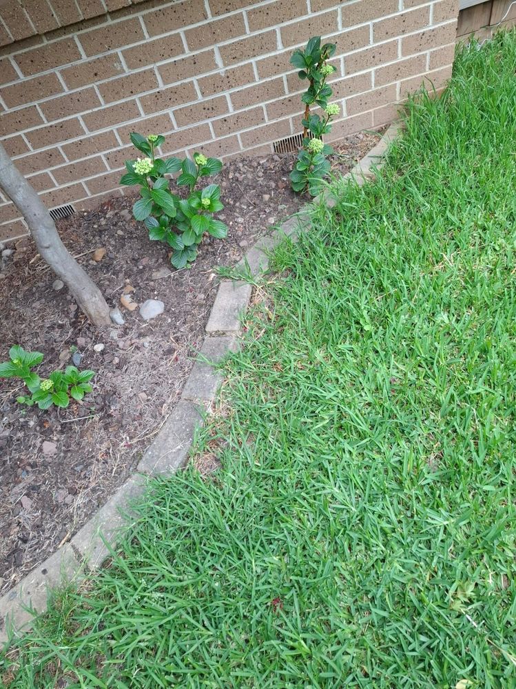

Thanks for getting back to me. I have attached picture of the lime tree I recently planted. Also, there is an existing bricked edge in the backyard, and I would like to have a new one that matches the existing one.

It looks like they've used 200x100 pavers in either a sand or cream colour that has gotten dirty over time. These Brighton Masonry 200 x 100 x 40 Pavers look like a great option.
I'd suggest starting by test-fitting your pavers to see how you like the look of it. As you are creating a curve with a much tighter radius than your example, you'd need to tweak it to your liking. A larger radius will have a gentler curve than a tight one. I'd suggest using a piece of string or jute twine to mark a circle around your tree with spray and mark paint.
You shouldn't have much of an issue with roots as you'd only be digging a shallow trench around your tree.
You can then excavate a circle around the tree using your marking as a guide. This trench should be a bit over 100mm wide and about 100mm deep.
Add a layer of road base or drainage gravel and compact it with a tamper so the top of your base is the thickness of your paver below the height you want it to sit. In the case of the Brighton Masonry pavers, this would be 40mm below finished height.
Once the base has been prepared, put your pavers in place making a gentle curve around the circumference. You can then use a rubber mallet to make small adjustments to the height of your pavers.
You can then backfill with soil and water it in to set everything in place.
