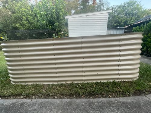

I am putting in a couple of birdies raised garden beds. My lawn has a slight slope. What would be the best way to level these out?
thank you
Hi @min611x
Nice garden beds there. ![]()
The best way if you agree is dig out a shallow area for the raised end of the garden bed to sit down level into the ground .
Use a spirit level or a board across it with a glass of water to show level length ways and level width ways.
Or place pavers etc under the lowest end and lift it up. But I not keen on the paver showing ruining the nice lines of your new garden bed.
Hope this helps.
