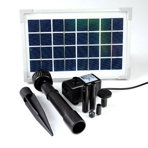

I propose using the AQUAPRO AP960SP Solar Pump & Panel Kit, it has a powerful pump and is designed for outdoor use. The pump itself will be submerged and the solar panel is meant to be left outside in the open. The only part that is in direct sunlight that might get damaged is the cable.
To protect the cable, I suggest using DETA 20mm x 20m Medium Duty Corrugated Conduit. It will protect the cable between the pump and the solar panel from the weather. It will also prove a deterrent to any wandering possums that might mistake the cable as a tasty snack.
