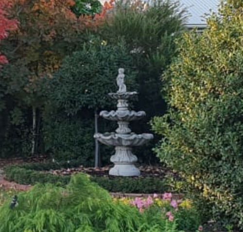

Hello,
We have a heavy old concrete fountain that has been a dry garden ornament up till now. Weighs about 250kg, height 2.1m, base diam 400mm. We have seen this same ornament in use as a fountain, which looked really good. So now we want to place it in a pond, and turn our old ornament into a fountain. I picked up a fiberglass pond shell 1.8m diam x .45m deep, which is perfect for the space we have.
What is required for a successful installation, where the fiberglass pond liner doesn't get damaged by the weight?

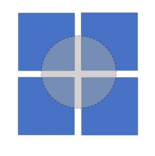

The real trick is getting a stable, level bed so a good layer of river sand is best. Stone dust can have small, sharp bits in it which can damage a liner (rigid or flexible).
You can then lay some large format pavers or concrete pads to stand the fountain on. I like to set these with a 30 or 40mm gap between them as this can give you easy access for piping etc. (see pic)
Also... make sure that your bed is compacted & stable before putting the liner in.
