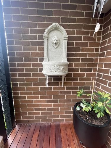

I’ve had this fountain put up but not happy with it. My griend putting it up said this is how the Bunnings man said it had to be done. Would a professional be able to put it up better. If not,
I guess I could put plants around it. Not sure what though. 2nd pic is the plants I have. Maybe split Fiscus on the right replacing the umbrella plant? Any ideas.

A better method would have been to install heavy-duty angle brackets upside down to conceal the brackets. This hides the leg of the brackets up behind the fountain instead of being visible below it. I see they've used stayed brackets with the diagonal brace. This type of bracket is typically stronger, so it might have been advised if the fountain is of a significant weight.
I think using plants to obscure the bracket is also a good solution and should look nice.
