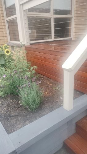

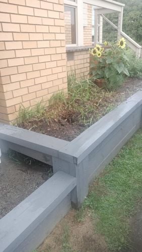

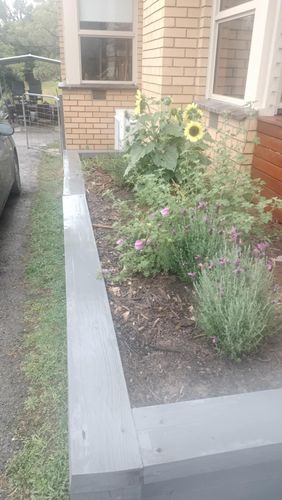

We've recently moved into a home where the garden bed has been built right up against the wall, meaning dirt is sitting directly against the brick possibly damaging it. What is the best way to fix this? Should we dig out the dirt and add a backing to the garden bed? (This could be complex as the decking would need to adjusted and the soil is solid clay). Or should we cut out loss and remove the whole thing and come up with a different solution?

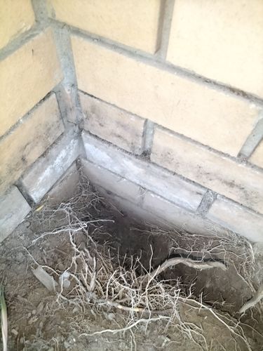

We've dug down to see where the foundation is, the dirt covers around 6 rows of bricks before it hits the concrete foundation, meaning dirt is most likely above the damp course.
(the concrete base is about level with the bottom sleeper of the retaining wall.)
I cannot see any visible weep holes at all in any part of the house (it's a late 70s home, doesn't mean they're not there I just can't spot them).
It looks like it may be best to add a backing to the garden bed and protect the wall? Not sure how this works with drainage though.

I agree with your suggestion; I would even go as far as installing a set of sleepers behind the garden and leaving a gap between them. This is to make sure that water will not touch or pass through your unsealed brick wall. Worst case scenario is that you'll get condensation on the other side of the brick wall due to hydrostatic pressure which will then lift the paint and cause damage.

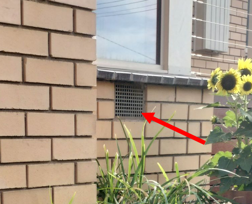

As @JacobZ eluded to, have you been under the house to double check that the garden bed isn't actually level with the brick footings? You may be concerned over nothing. Plus I can see there is a vent under a window. Is there more like this around the house? Vents were more common than weep hole gaps in the courses for that era home.
