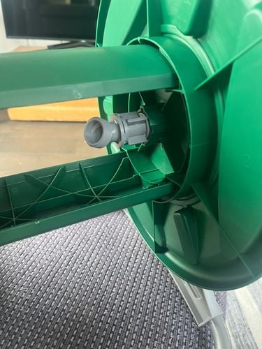

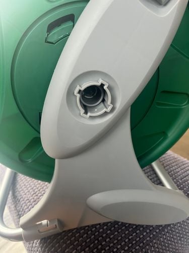

I have just purchased a garden basics hose reel and followed the instructions to the letter. However the last step is impossible. The instructions say insert the elbow hose connector but while it will go in it won’t how through far enough to attach the hose connector on the outside.

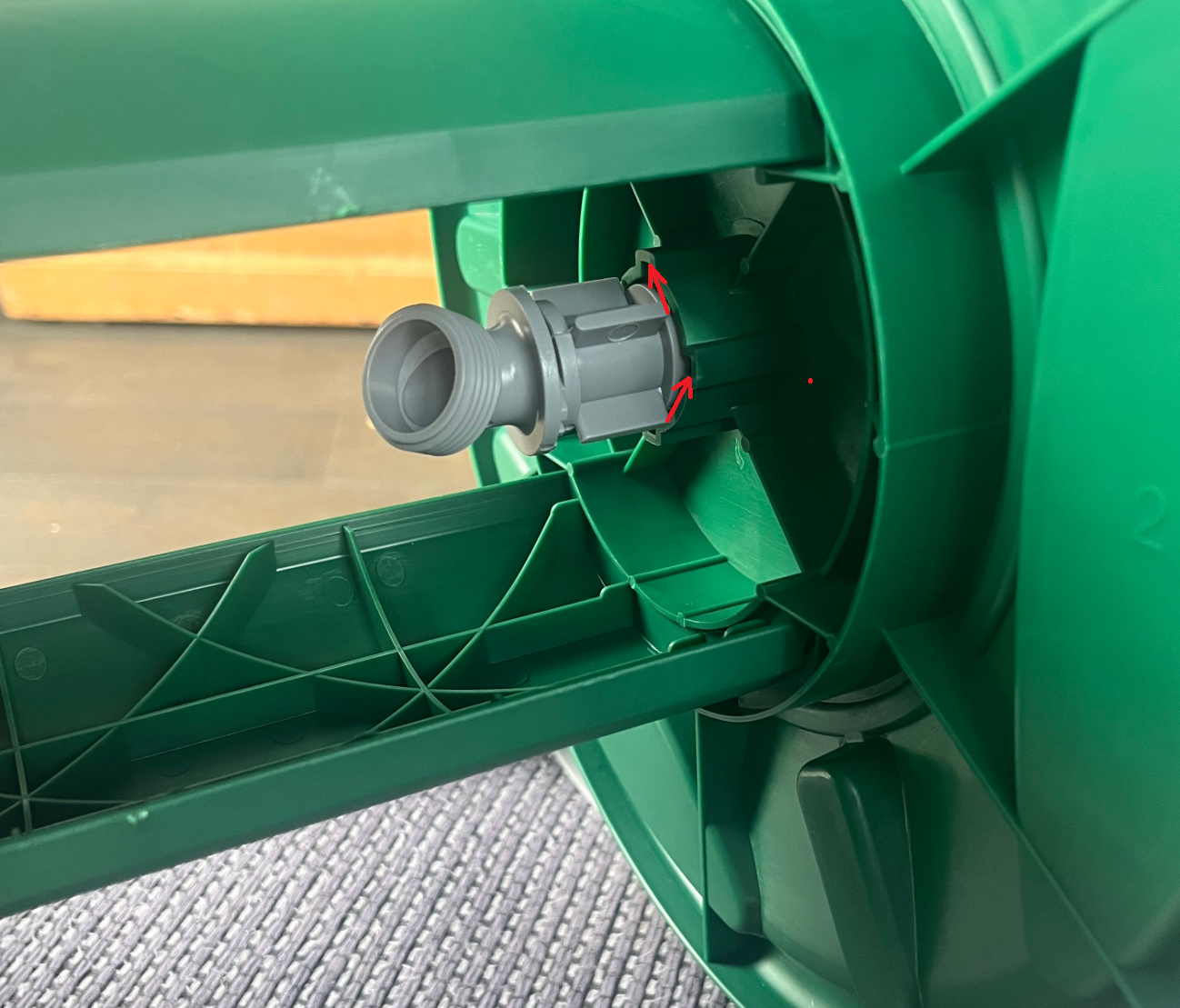

You're almost there! The internal connector has four inserts on it that need to be aligned with the cutouts in the reel, so it can push further through. Spin it around a bit and then push it through.
Thank you!!! I just wasn’t turning it hard enough!!!!
