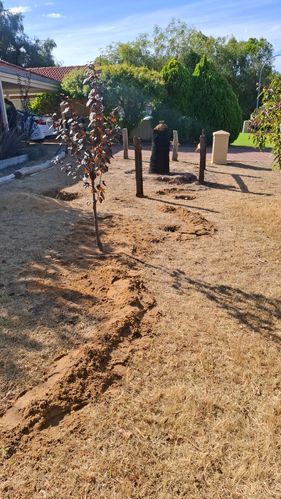

The first pic is of the dead grass situation. The second pic is the small sand bunds (mounds) we are creating to prevent the wood chips sliding down the slight slope we have when it rains. We are going to cover them with ground cover eg. Pig face and grevillea.
The street side of the mounds is our boundary so will plant more ground cover and couple of grevilleas on the street verge.
Do you have any suggestions?
We are planning a gravel path house side of black boy. How can we avoid it needing edging?
I really appreciate your help Mitchell.

Hi @KarenMay,
It looks like the grass is dead enough that simply laying mulch over the top with some cardboard or weed mat will do the trick.
The small sand bunds you’ve created to stop the wood chips from eroding are a smart move. Once they’re planted out with ground covers, they’ll help stabilise the area even more. To give your plants the best start, it might help to water the mounds deeply a couple of times and mix a bit of compost into the top layer before planting. If you’re open to a bit more texture, you could also add some small native grasses or sedges like Lomandra, which is compact and hardy.
You could reduce the need for a border by digging the outline of the pathway around 100mm into the soil before adding your gravel. Once in place, you can plant your choice of small groundcover plants along the path to create a natural border and to lock the soil in place with root growth.
