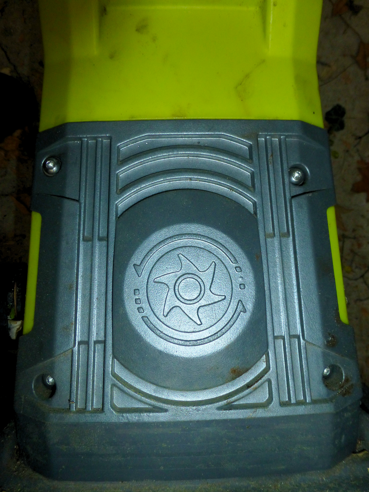

After 6 years occasional use my shredder started making a metallic noise resembling bearing failure when it wasn't under load. Removing the front cover revealed 3 of the set screws holding the steel face plate to the cover were missing & the 4th was loose. The drive shaft & white metal bearing looked OK. There was about 1mm of play in the shaft without the face plate.
I replaced the set screws using Locktight, greased the drive shaft & re-assembled.
The shredder still sounds as though the main bearings are shot whether under load or not.
Is this repairable?
Are replacement bearings available?
I would also like to know if the sacrificial aluminium shaving plate
is still a spare part.
The RSH2445T has performed very well to date. I expected to get >12 years out of this machine so I am disappointed in its longevity
