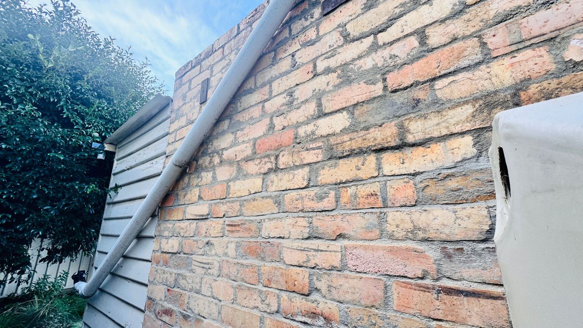

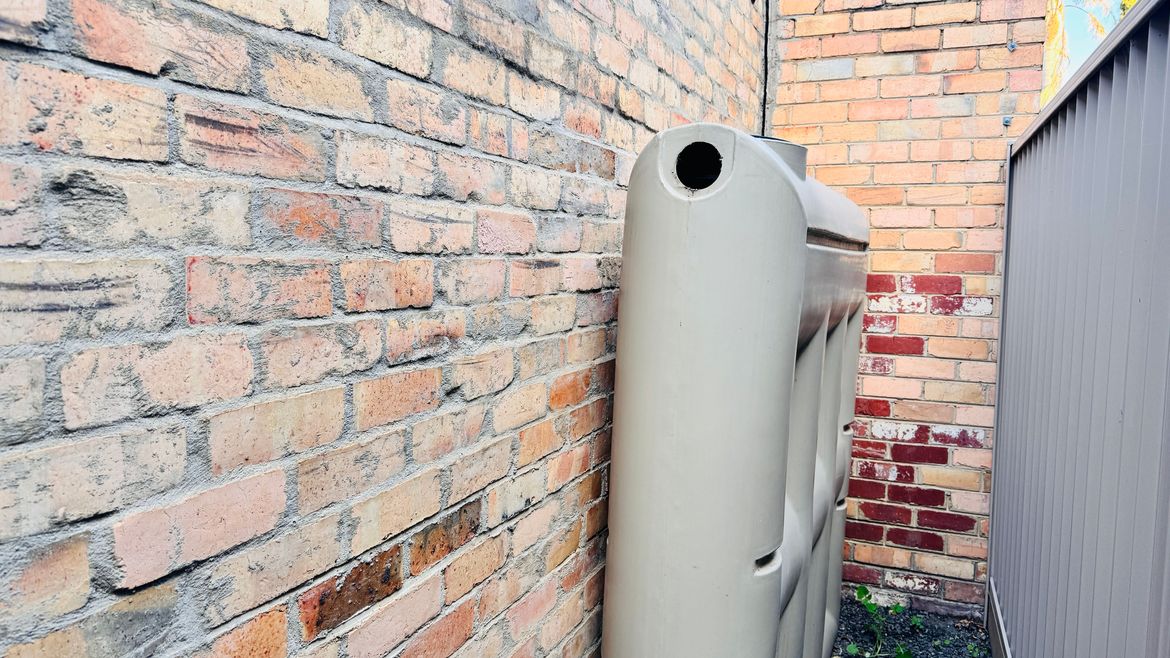

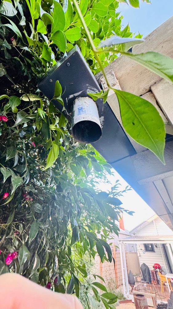

Have purchased a new water tank recently and need to repair our existing pipework coming from the gutter of the shed to the new water tank. As you can see the old pipe was patched on with gaffer tape but hasnt quite stuck.
New water tankNew water tankPipe end that needs replacing to fix securely to gutter.Pipe end that needs replacing to fix securely to gutter.Gutter pipe that probably needs replacingGutter pipe that probably needs replacing
The rest of the pipe looks pretty good but will need some additional joins to get it away from the wall and stretch out to the water tank:
Pipe that needs rotating outPipe that needs rotating out

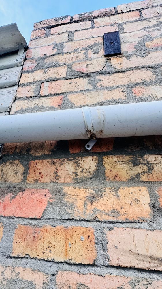

Need to replace this bracket too that is currently screwed to the brick:
Bracket that needs replacingBracket that needs replacing

The pipework can be securely repositioned using appropriate pipe brackets, eliminating the need for gaffer tape and preventing future sagging. The plumber will likely install a T-section along the downpipe to divert water into your tank. To ensure cleaner water enters the tank, I recommend installing the Rain Harvesting 90mm First Flush Downpipe Diverter. This device helps remove dirt and debris from the initial flow, keeping your tank cleaner and reducing maintenance.
