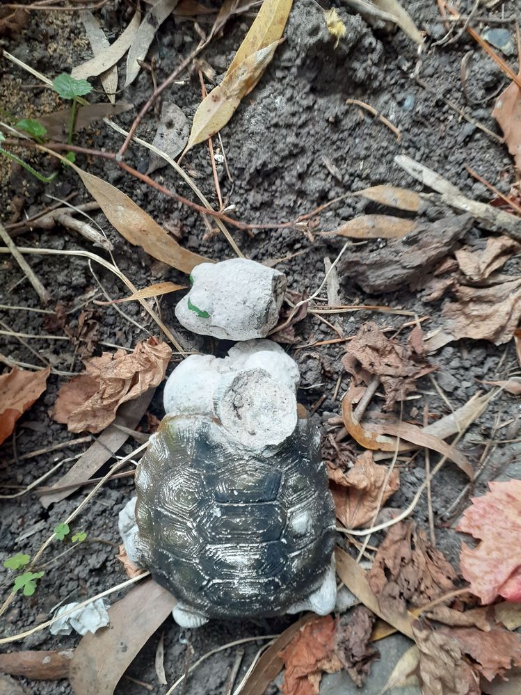

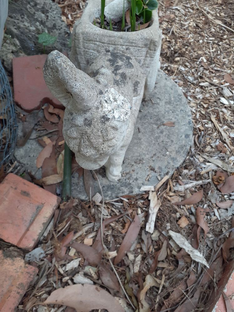

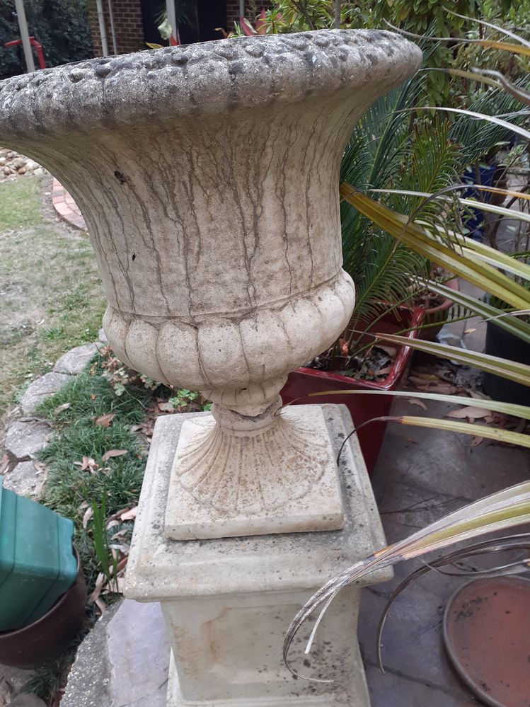

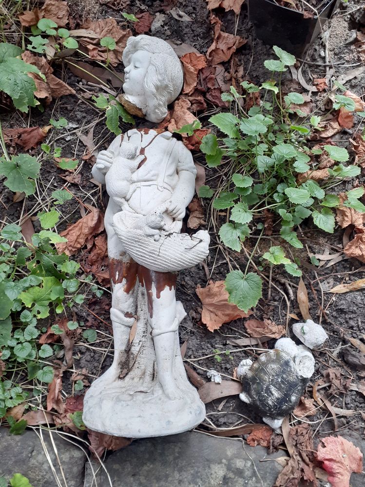

I have one statue the head has come off, a donkey the ear has come off, a turtle the head has come off plus a large pot and stand combined which has also come apart. All are concrete coloured. What is the best type of glue to use that will not show up as a yellow or brown colour and drip like the one I did before on the statue?
donkey lost an earstues lost a headpot broken above baseTurtle lost a head

What sort of adhesive did you originally use on these?
Masonry is terrible in that it is quite porous and will soak adhesive up like a sponge.
The other thing is, the parts that you've already glued and have broken, will need to have all of the glue removed with some sort of a solvent, that is why I asked you what sort of adhesive it was.

With most of your items that need to be repaired, they should be fine done in-situ, the pot with the broken base however will need to be braced for 24 hours while the adhesive cures and strengthens the joint.
