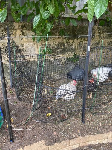

We used 1.8 metre Steel Posts, used a Post Driver to secure them into the ground.

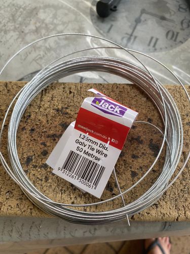

Galvanised Wire for extra support to attach the Chicken Wire too.

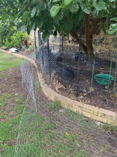

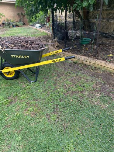

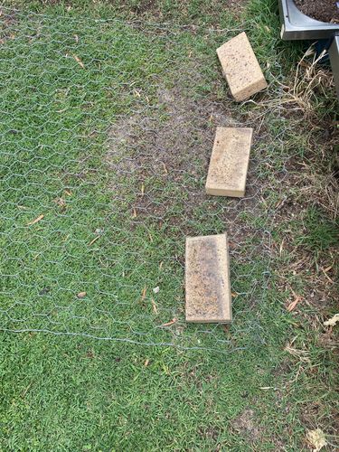

Make sure to wear work gloves when working with Chicken wire fencing. Also, I used a few bricks and the wheelbarrow to hold down the fencing and stop it recoiling on me , that was fun and games 😆 It’s quite tricky but it was worth it.

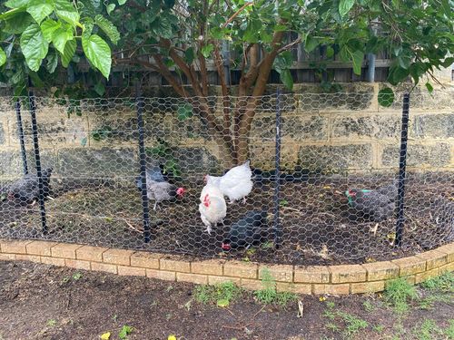

After completion, it’s so much sturdier, looks heaps better and NO escape attempts 🐓🐓 All materials were purchased from Bunnings.

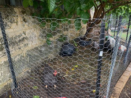

Steel Posts are in and galvanised wire run through them for extra support. You can see the old crappy plastic trellis here.
Really happy with this Heavy Duty

Galvanised Wire I used

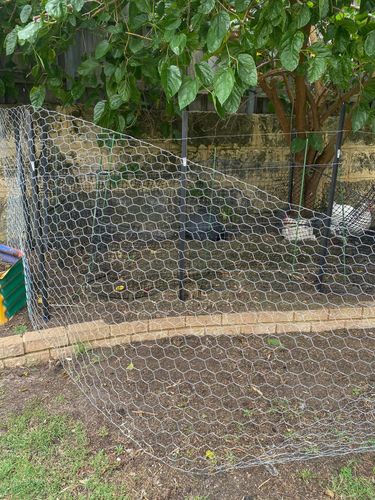

I used bricks and the wheelbarrow to hold down the mesh to stop it recoiling itself. Please make sure you wear a sturdy pair of work gloves when using galvanised fencing.

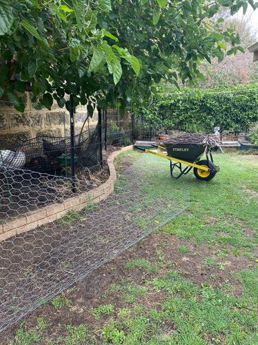

I added the fencing, section at a time and cable tied to the posts. You can use wire as well.

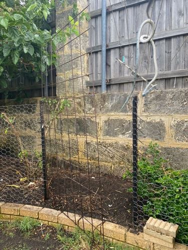

Added another access gate using Reo Mesh

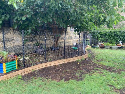

Finished and I removed the old fence
