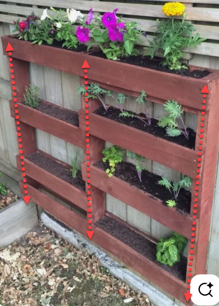

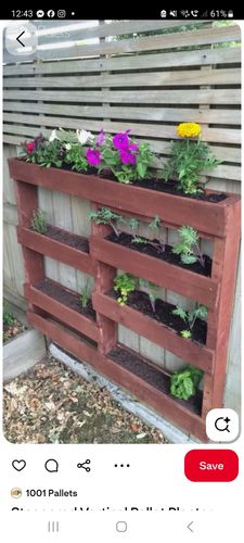

This picture is the inspiration behind this project.

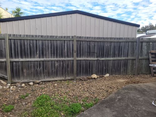

And this is what I'm working with in terms of my fence and backyard side

I'll start by mentioning that pallets are not treated for direct contact with soil. There's no reason you can't use them in this application, but you can't expect them to last for a lifetime, and you should expect the timber to degrade or rot at some point. As long as you are happy with this, let's proceed.
You'd have to start by adding a bottom to each of the planter boxes. If there are spare pallet boards, you could use them, or you could use 90 x 12mm DAR or 64 x 19mm DAR, depending on the thickness of the pallet. You could use a 3mm drill bit to put some pilot holes, every 300mm or so, through the base piece into the bottom of the pallet boards and then use 40mm Galvanised Timber Screws to fix it in place.
You could then use some galvanised angle brackets with the same screws as above to attach the pallet to the fence. Attach the brackets to the pallet's runners and the fence rails for the most solid connection.
