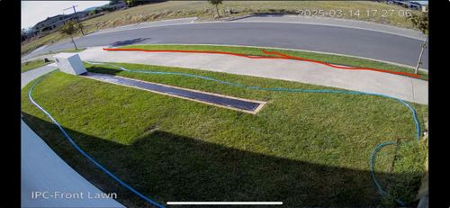

Hi Jacob that’s copied the Holman sprinklers that you’ve recommended would they cover the entire area from where they’re installed until 2-3m or would there be blank zones under the spray. There are certain areas which are only about a meter wide that need to be sprayed what could you suggest for those areas? Also can you suggest how I can install the hose across a cemented walk path to spray along the road unless there’s something that you can suggest that’ll throw a spray across the cemented walk part onto the grass along the road? Not really sure how to cover that area of grass? Please see photo attached talking about the grass area between the red line and the road

Re: How does an absolute Newbie set up an automatic irrigation system for watering grass,gardenBe...
Hi @KSB,
Can I ask for some dimensions of the area?
The plans from your original post give us an idea of the dimensions, but they are not perfect.
Can you perhaps draw the area like @TimGeo has in his post How to install a lawn irrigation system attached to recycled water?
Sprayers will spray the full area covered by their radius, so depending on the dimensions, you may be able to just run one line of sprayers to cover both sides of the footpath.
If not, you can always run a line beneath the footpath. You can use a hose or pressure cleaner alongside some electrical conduit to carve out a channel beneath the footpath for your irrigation line.
I'll have a good look at what we can do once I can see the dimensions.

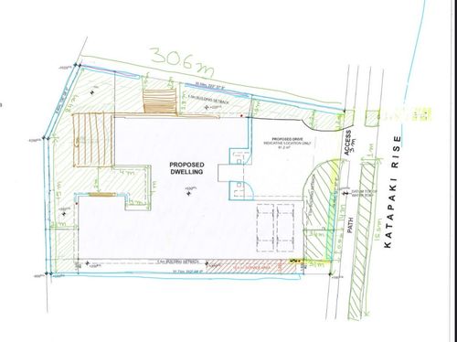

Hi Jacob PFA a diagram hopefully this will give a good idea. All the light blue line sections are 1/2m wide garden beds that need to be watered pretty much along the perimeter of the house and slightly bigger squarish ones on both sides of the main entry door.
The light green stripes are all grass areas that need to be watered. Have worn all dimension in light green as well hopefully they’re self explanatory. Brown lines are the wooden deck. The entire rear boundary of the house the 1/2m wide garden in light blue has griselinea hedge already planted. All other gardens are yet to get plants. Planning some citrus fruit trees as well along the side of the house marked with a magenta line. Have 3 taps on the outside marked with Red dots. All three run from the same main water line so The water pressure drops when 2 or 3 are running at the same time so will  have to be planned to run at different times.
Hi @KSB,
It looks like three fairly obvious grass zones will connect to three different taps and then your garden beds in the blue. I would focus on the grass zones to start with.
Perhaps you should sketch a layout plan for your irrigation zones with the origin starting at the taps. If you are going to use pop-up sprinklers, keep in mind that you can have full, half and quarter sprayers for different circumstances and coverage.
Also, keep in mind that you can have more than one irrigation line coming from each tap to service the drippers in your garden beds.
A basic layout plan for your irrigation seems like the place to start.
