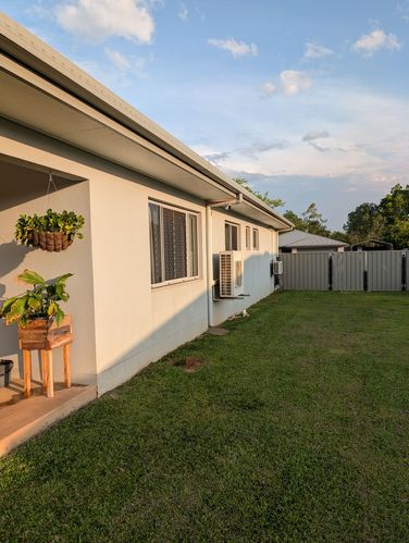

I am looking for ideas to shade the Western side of my house. It gets full sun from midday on and really heats up the house. Ideally something not too wide as there is vehicle access along this side which I don't want to impede. Open to anything, plants, hedges, screens etc. but I do have dogs that love to destroy plants, so it'd have to be something out of their reach. I live in far north Qld, so tropical climate.

Thanks @EricL for your suggestions on outdoor blinds & a great idea. I did seriously consider this option as it is relatively simple and quick to install, however the sun up here in north Qld is something else! I can actually feel the heat on the inside of the wall just by hand, and aircon is non-negotiable all year, so I would prefer an option that will shade the walls as well as the windows.

Good Evening @kchris
QLD sun is fierce, so I was thinking of options that would work within the use of the yard and your doggos.
The idea that popped into my mind is similar to @EricL 's and not as flexible but would work to keep the sun off your walls.
Picture this -
Same timber that @EricL has suggested installed out near the Facia. I would suggest segmants of 2.4m just as a standard.
Then for every 2.4M install 4 of Everhang 20mm Zinc Plated Screw Eye Hook 10PK 72438 or the 30mm version
Choose the sandy coloured shadecloth Pillar 3.66 x 10m Cream 90% Shade Cloth
Then sandwitch the shade cloth end between two pieces of H3 timber. Screw the timber then shadecloth then the timber together.
You can then either install eye bolts or hooks that match up with the ones in the eave.
The two could be joined together with marine rope, wire, cable ties or chain links.
Hang the screen.
For the second part, Its pretty much the reverse of the top connection.
Then using Polytuf 300mm Anchor Screw - 2 Pack secure the bottom eye bolts to the ground using Grunt 10mm x 25m White Braided Marine Rope
You can then repeat along the length of your house.
As the shade cloth witll be vertical, vehicle access should be ok, being up to 500-600mm off the wall the sun wont be beating down on the wall so you have an air gap insulation. Best part yet is that you can remove in winter and roll up to store.
