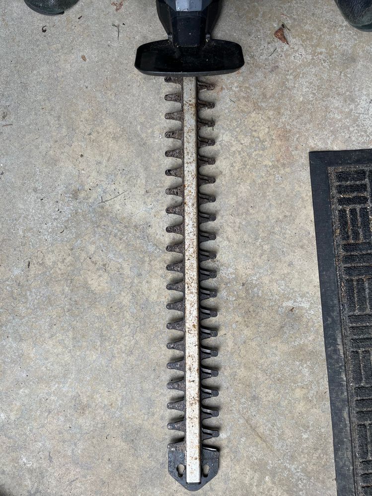

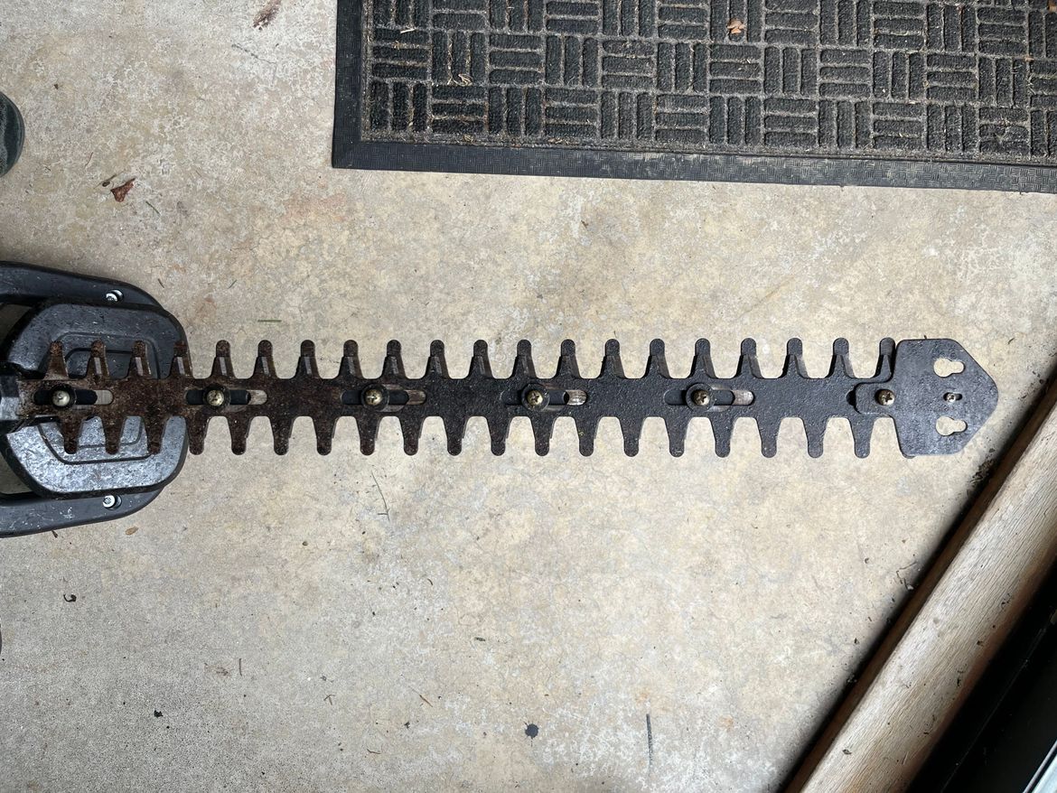

Hedge shears are self sharpening for the most part and typically only require periodic cleaning to prevent sap build up on them. This sap build-up separates the blades and reduces their ability to cut fine material. If the blades are so damaged that they are blunt, then sharpening can be done with a file. Before I recommend doing that, it would be great to see some images of the blades so we can assess whether they need to be sharpened or cleaned. Let me know if you need a hand uploading images.

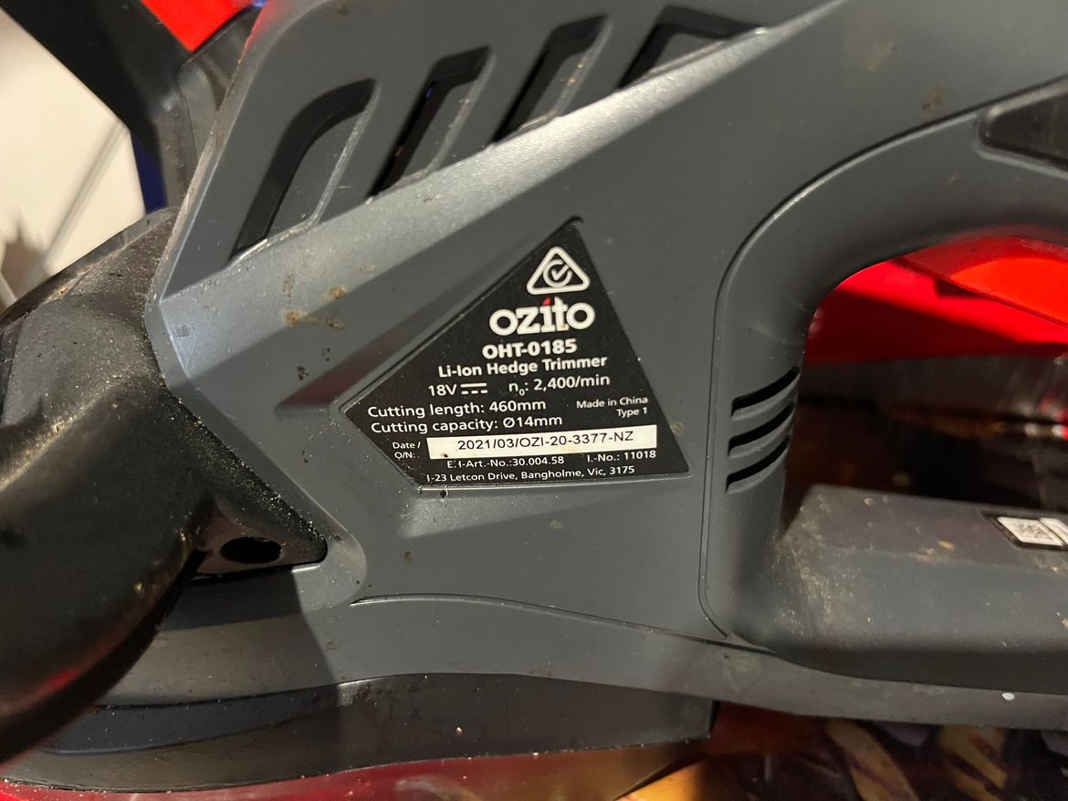

I have the same question. PleaseModelModelBottomBottomTopTop see photos attached and advise.

As stated earlier in the discussion hedge shears are self-sharpening for the most part and typically only require periodic cleaning to prevent sap build up on them. This sap build-up separates the blades and reduces their ability to cut fine material. I strongly suggest washing the blades in water and detergent along with a scrubber to remove and strip any build-up on it surface.
The general steps to sharpening the hedgers blade is to start by unplugging or removing the battery from the trimmer for safety. Then, clamp the blade assembly securely in a vise. Use a file or a suitable sharpening stone, angling it to match the blade's bevel, and sharpen the cutting edge with forward strokes, avoiding a back-and-forth "sawing" motion. Remove any burrs with a whetstone or fine file and consider using a lubricant such as WD40 to prevent rust.
Please note that if you've not done any sort of tool sharpening activity, I don't recommend doing this as a first D.I.Y. project. If the tool is sharpened incorrectly, it will blunt the cutting action of the tool. In these circumstances, I suggest bringing the tool to a lawnmower/garden tool service shop where the hedging blade can be sharpened professionally.

I have to clarify that hedge sheers and hedge trimmers are different in that hedge trimmers are not self-sharpening unless specified. Most DIY models like yours cannot and should not be resharpened due to the type of metal. Attempting to do so will only damage them.
The best you can do is use a wire brush to clean them and then use this WD product to help remove the build up of corrosion and lubricate the blades that make them foliage safe. In other words won't burn the foliage when contact is made. Spray this lightly over the blades after each use.

I am with the thinking of cleaning the blade more then trying to sharpen the blade for the same reaqson @EricL and @Nailbag have mentioned.
@Nailbag actually has a good point about the blades and how they are manufactured.
