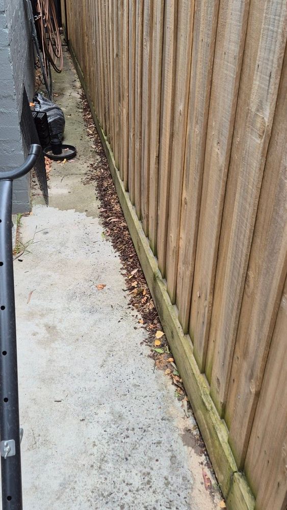

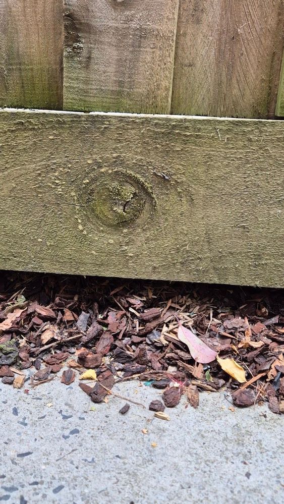

Our block is slightly downhill of our neighbour, and we have concrete on our side of the fence, while she has soil/mulch. When we had our fence replaced, the installers left gaps between the concrete and the plinth of the fence, and now next door's mulch is constantly sliding underneath the fence. The more you sweep, the more it falls! There is a gap of about 80mm at the widest.
I'd love some advice on what we can do to keep the mulch on its right side. We're on good terms with our neighbour, so she'd be open to installation of products to solve this. I was wondering about installing some garden edging along the bottom of the fence on her side, as it could be dug slightly into the soil, beyond the depth of the concrete on our side. Her side of the fence is painted monument, so it would also be easier to disguise on her side than ours, if we could get a product that could be painted, or was already a dark colour.
Thanks for any advice that can be provided!
There is a gap of about 80mm at the deepest point.
Hello @gardenhappy
Welcome to the Bunnings Workshop community. It's sensational to have you join us, and thanks for sharing your question about your house fence.
I propose two possible options, first is to remove as much of the mulch as possible and filling the gap with Dingo Fast Set Mortar - 3kg. My second suggestion is to use 100 x 16mm 4.8m Edging H4 Treated Pine Wet and placing it in front of the gap. Parts of it will need to be trimmed so that you get a positive seal on the concrete. Please note that the cut edges will need to be sprayed with Tanalised 300g Clear Enseal Timber Treatment.
Please remember to wear personal protection such as gloves, goggles and mask when using this spray.
