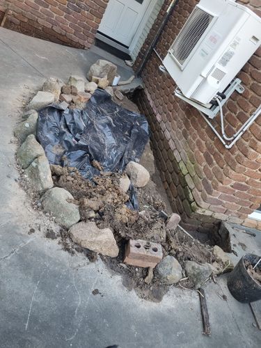

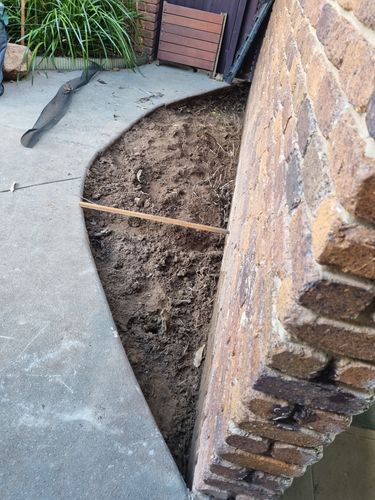

We moved into our house in 2019 and on 2 occasions since then our lounge room has flooded during heavy rain / cyclonic weather over 5 days. We really want to try and avoid this happening again! We think the rain comes in because right next to the house are 2 garden beds. Until recently, one of the garden beds had 3 camellia trees. It has taken us weeks to get to the stage in the photos as camellia roots are as hard as steel and they have grown into the brick wall and under the concrete. We think the best thing to do is to lay crusher dust, then sand then pebbles. However the concrete already down seems to cover half the weepholes for a short distance. Are we OK to go ahead with our plans for a pebble garden or should we take up the concrete which is half way up the weepholes? Should we seal the wall before filling with drainage gravel? How deep do we need to dig?
