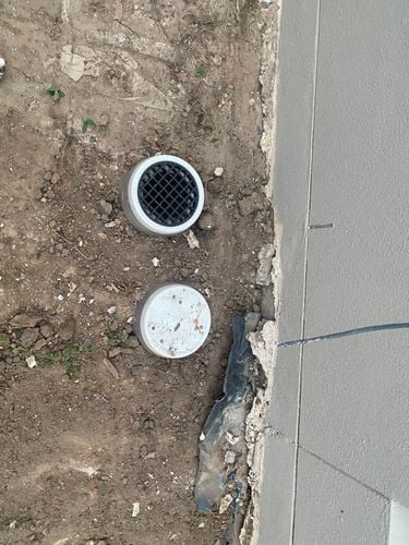

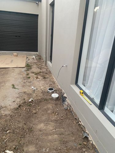

I have two drainage inspect point(don’t know what exactly they are) outside my laundry. Pls check my attached photos.
I’m going to tile this area, but I don’t know if the floor level can higher than that two point or must be same or below that two point. One looks like discharge point, I don’t know.

The one with the cover cap is probably an inspection junction and the one with the grill is possibly an overflow inlet. It looks like your house is newly constructed, I suggest speaking to the Engineer who designed your house. They will be able to provide you with the information that you need.
The engineer will be able to tell you if you can tile up to the edge of the pipework or leave space around it so that you can service them without having to break the floor tiles in the future.

Hopefully someone can point me out. I don't need to too high then the point level, maybe just around 35mm higher. I don't know if it is okay. thanks anyway.

The capped pipe does look like to be an inspection pipe and can be raised by extending the pipe itself.
The bad news the other does look like an overflow that @EricL suggests. Being an overflow I would suggest that it is already at the right height to provide this service 😕 It looks to be at the same level as the bottom of your floor, that way if the pipes overflow it will come out here instead of in your house.
You could contact a plumber and they may know a way around the issue? If you raise the area higher then the bottom of you house slab I would have to make sure of what happens to the water that falls on it (running on that new tiled area but between the new tiled area and house)
Thanks David-1, I will take your recommendation, properly just lower the floor level flush with the overflow inlet. thanks again for everyone..very helpful.
