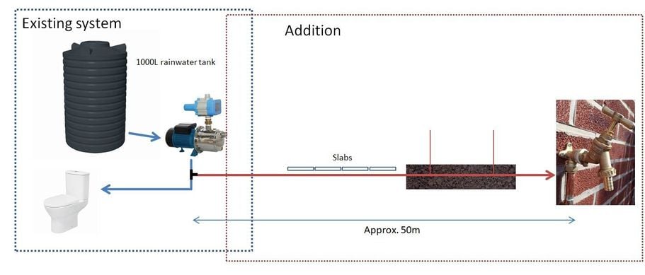

I currently have a 1000L rainwater tank in the back garden, which is only used to supply one toilet using an automatic outdoor pump.
This seems a bit of a waste. My plan would be to somehow use this pump to also supply this rainwater to the front of the house (where there is currently no water supply) to water the garden/wash the car.
As can hopefully be seen from the attached diagram, my plan is to Tee off the pump outlet, run a pipe under a patio (trench and protect with sand), through a garden bed and probably use a Tap Post so I can use a hose. Distance is approx. 50 meters round the side of the house.
I would also like the option to possibly use this pipe to install Drip Irrigation along the pipe at the garden bed. This would, naturally, only water the garden when the pump is activated. I could either manually run the pump to water the garden or simply allow it to happen as a side effect of using the toilet or front-of-house hose.
So my questions are as follows:
1. Would it be possible to use standard Poly Pipe? Or could I use a 'standard' garden hose?
2. Would there be water pressure issues? The system would be 'closed' so I don't think so.
3. What have I missed?!
