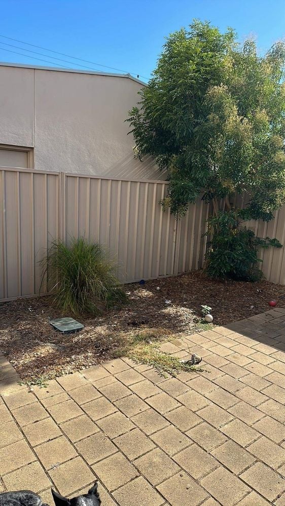

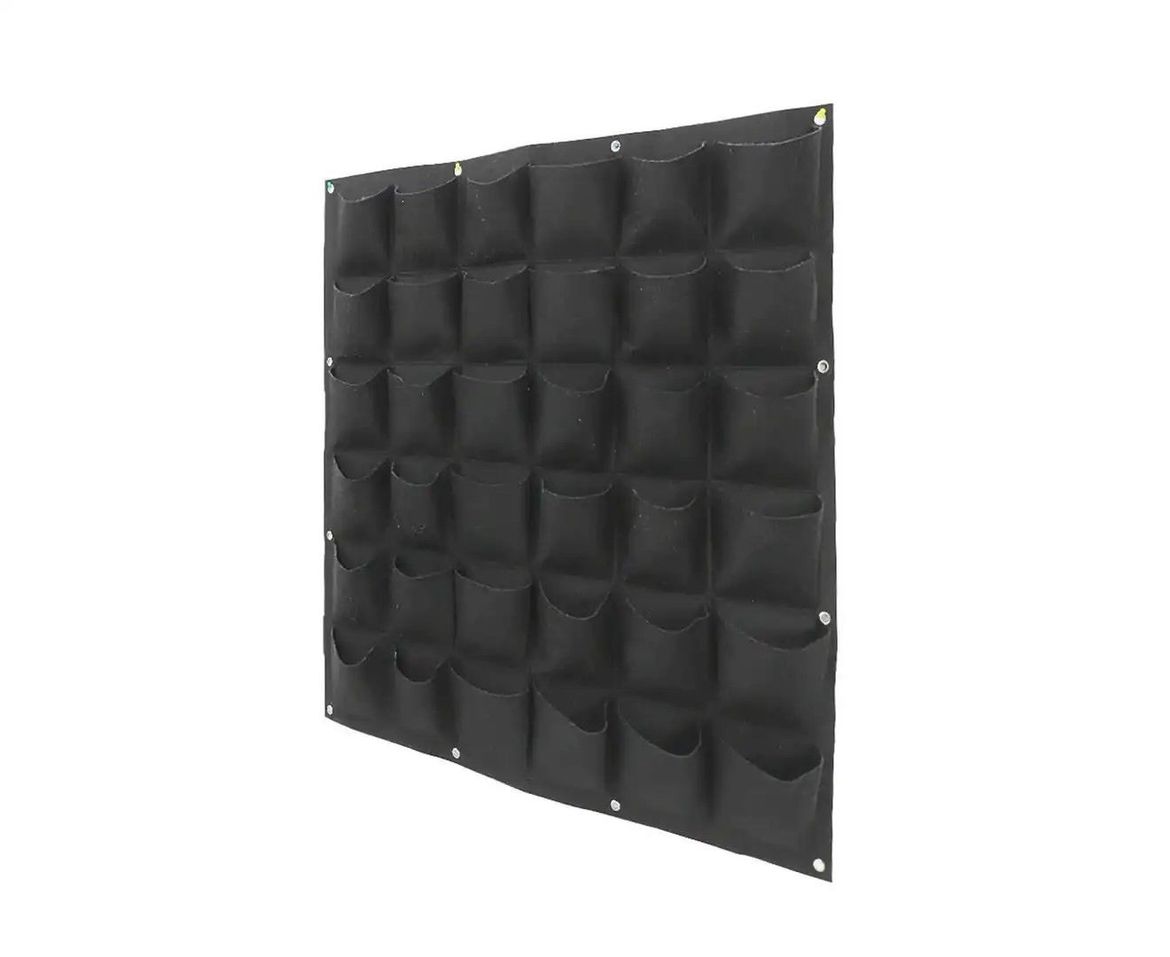

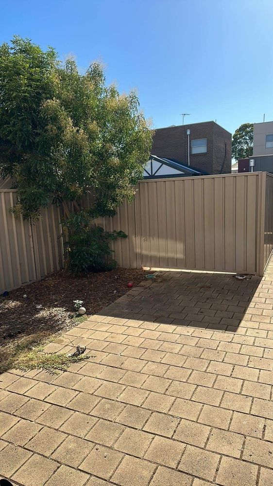

Hi, I'm looking to make a a vertical garden in my backyard on the Colourbond fences below, using the pocket squares as seen in the third photo. The area gets around 4 - 6 hours of sun a day. I'm wondering how I would attach the vertical garden to the fence or if there are any alternative solutions, Thankyou.

It's great that you've decided to start up a vertical garden. Hanging your vertical garden on the Colourbond fence is possible, however, the drawbacks include staining and shortening its expected life span due to contact with the soil and water. There is also the possibility of the Colourbond bowing due to the weight of the garden itself.
I suggest putting in two 88x88 posts and some 70x35 timber pieces to form a frame for your vertical garden. You can fix the timber braces in place with standard galvanized screws. This guarantees that the garden will not sag or swing and will be able to put up with the weather. I've placed a sample sketch below to give you an idea of how to set it up.
