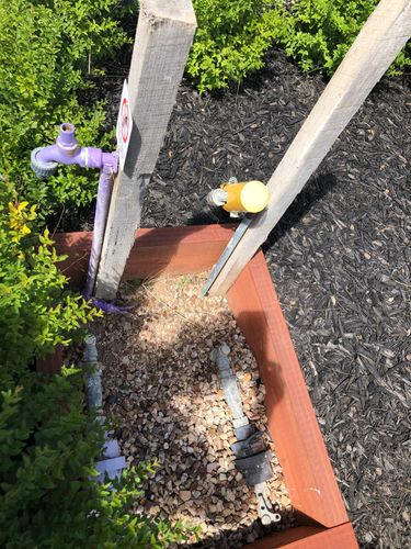

Did you already have water supplied to this area? If so, you might like to upload an image of the pipe/connector so we can see what you are working with.

Hi Mitchell
this is what I’ve got now and wanting to replace the timber piece with the garden post. Do I still need a plumber for it?
Thanks.
Re: Installing a Kinetic 15mm garden post with tap
@w1soon,
Those water pipes are considered mains plumbing and not a D.I.Y. job. As a D.I.Y.er you are limited to replacing washers and aesthetical hardware like showerheads. The water needs to be disconnected to install the new upright post, and the garden border removed. You'd then dig out the old post and footer. Once it is removed, the new upright post can be installed and the water re-connected.
