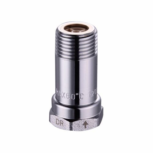

Also could you recommend a suitable 'backflow prevention device' that would be compatible with the pipe and a standard tap? Is this the sort of thing I need?
https://www.bunnings.com.au/kinetic-chrome-backflow-preventer_p4920512

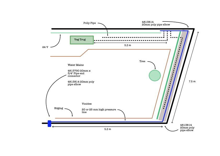

Re: Irrigation, merits of various water pipe options
Thinking of something like this...

It's great that you've received excellent advice from @Adam_W and @robchin. To answer your first question, you can install a FIX-A-TAP 19mm (3/4") Vacuum Breaker. This will cover your entire setup from the garden tap, but if you wish to install more non-return valves it is possible to do so.
