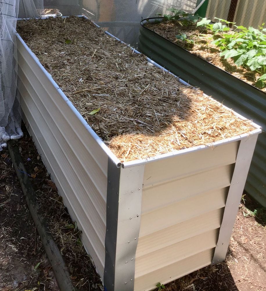

This is what a finished version of my steel raised veggie garden bed looks like next to a Birdies kit raised garden bed...

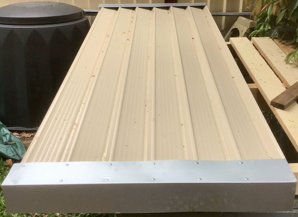

For the corners, I have used 100mm x 100mm zinc angle. This is thin material that is easily pop riveted to the side sheets and readily available at Bunnings.   I bought a couple of 1.8 m lengths for each of my raised garden beds and cut them in half so as to match the width of my sheeting and which also allowed another few centimetres that can be shoved into the ground to anchor the raised garden bed.
Construction is simple enough. The end panels were cut to the desired width with an angle grinder and the corner angles were secured with pop rivets.  For ease of construction, I affixed the angles to the sides first using a pallet on saw horses as a work bench...

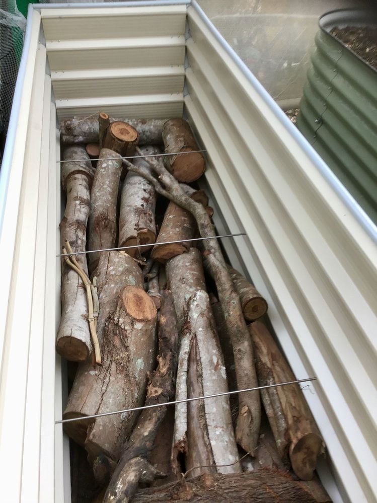

The next step is to do something to stop the sides bowing out when filled with soil.  This is done by screwing the sides to each other with a few 6mm threaded stainless steel rods cut to length and with washers and nuts on the outside.  See the rods and even spacings in the picture below.
Finally, to make the edges safe, very cheaply,  I have used 20mm PVC conduit that has been slit down the side with a multitool and slid over the edge of the sheeting, as seen in the pictures above also.  That PVC conduit is dirt cheap at around $3.50 for a 4 m length and is to be found in the electrical section at Bunnings.
In terms of filling the high sided raised garden bed, I have used the Hugelkulture method.  That is, fill the bottom half of the raised garden bed with hardwood logs and sticks first. These logs will store water more than dirt will. Then I have covered that with layers of home made compost and garden soil.

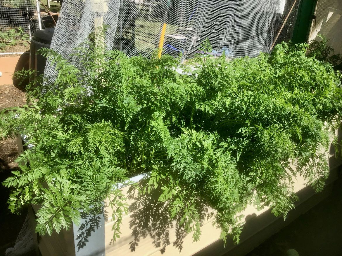

Does it work?  These healthy carrots, grown in the same bed as pictured above, tell the story.

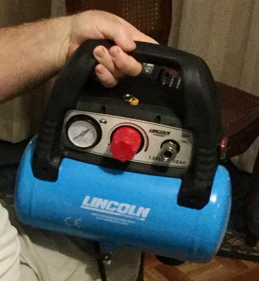

[*. I will confess to cheating a bit in relation to the pop riveter.  I started the job using a manual pop riveter but found that for my ancient arthritic hands, that was a bit slow and hard to do because I did use some fairly large pop rivets.  Then, when I mentioned this to a mate, he gave me his old pneumatic pop riveter that he had no further use for. When I married that to my cute little hand-held air compressor as shown below, the pop riveting became dead easy and, frankly, good fun.]
