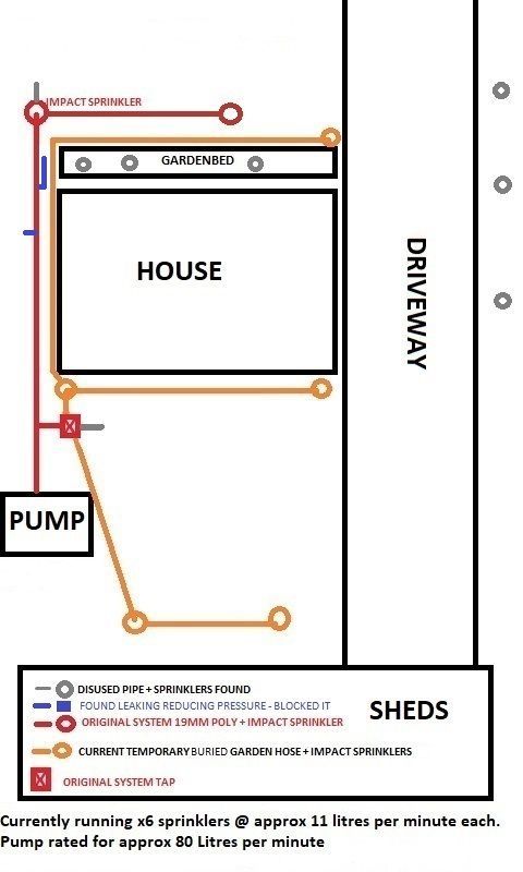

Just as a sidenote - if you think you will expand or dig things back up again in the future - a "mud map" you create of where all your pipes are can help as you find them or put new ones in (years down the track you might not remember where everything is, and if u get a leak it saves digging half the backyard up chasing pipework lol, and a rough plan can also help u visualise any later adjustments, and addons if you want to tap into a existing line  - or in my case - keep track of all the old fittings etc I found  lol20190129 irrigation.jpg

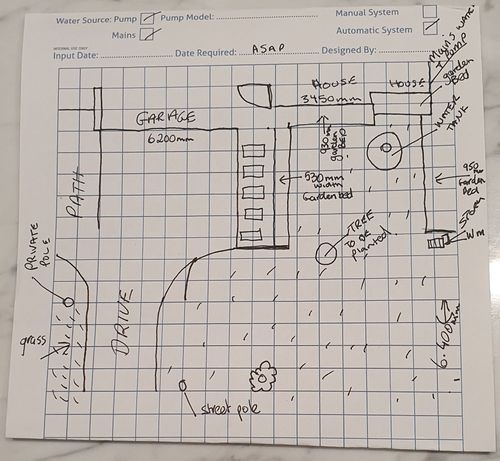

Hi I uploaded a picture its 1 meter 1 square roughly. Im hoping just a dual timer will be enough but if I need to use solenoid Im slowly getting it!

@Nev,
There is no need to use solenoids in this application. A dual outlet tap timer will allow you two separate irrigation lines that run independently of each other and have specific runtimes. Those two lines can run in different directions to cover all the garden beds. You could easily run this entire system off a single outlet tap timer if you are happy with all the areas receiving the same amount of water and runtime.
You might like to consider using Pope micro sprayers instead of pop-up units. They screw into the standard poly pipe and are very easy to install.

Thanks so much I bit the bullet today and Hubby and I tackled it together I was the supervisor and planner Hubby provided the muscle,We were successful in all pop ups working so we will fine tune once turf is down .This site was very helpful in giving me the confidence to do this thanks for everyone's help will post a pic once complete.Cheers .
