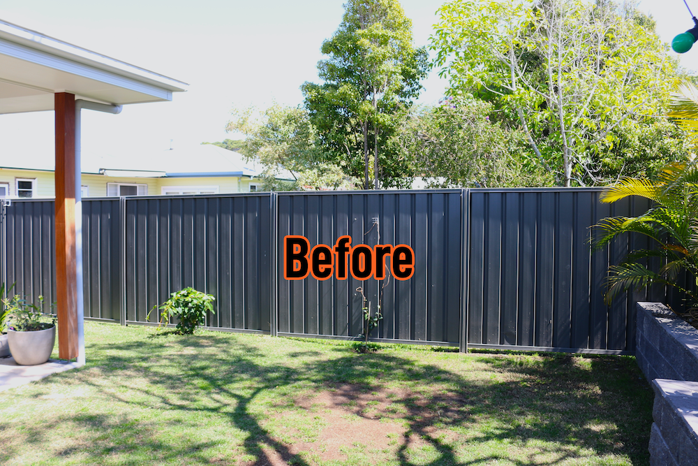

We had a dead area in our back yard that was always to wet for anything to grow. With that in mind we decided to build a trellis fence out of recycled hardwood floor joists, with Cor10 (Corten Steel) Planter Boxes in-between. The planter boxes kept the new plants off the ground and instead of dying, are now flourishing! The sketchy grass was also removed and replaced with Paving. It finished up totally transforming our back yard and we couldn't be any happier with the result.

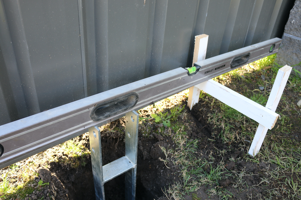

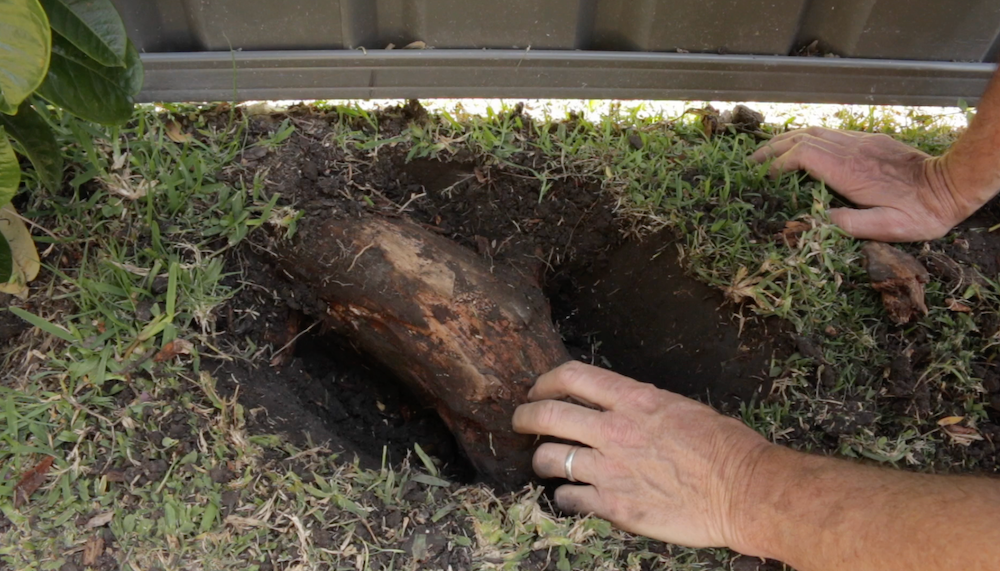

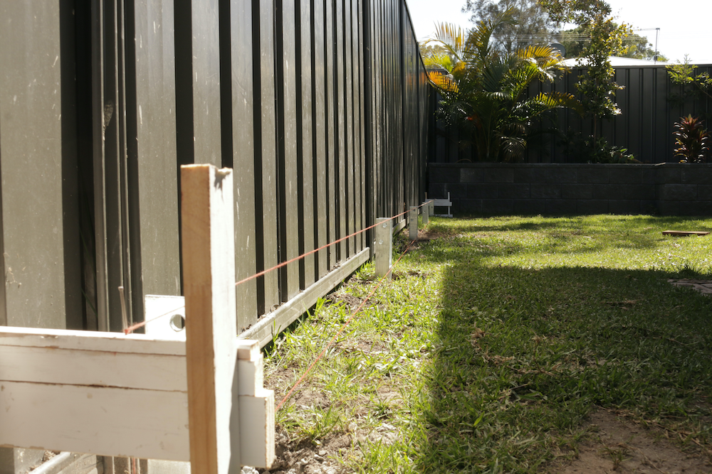

Like all fence type jobs, setting out the job and digging the holes was the first cab off the rank. I came across a lot of dead tree roots so the reciprocating saw was amazing at easily cutting through those.
Setting Up Profiles.pngSetting up stirrup string line.pngStirrup height.pngNew Tree Root.pngNew Recip.png

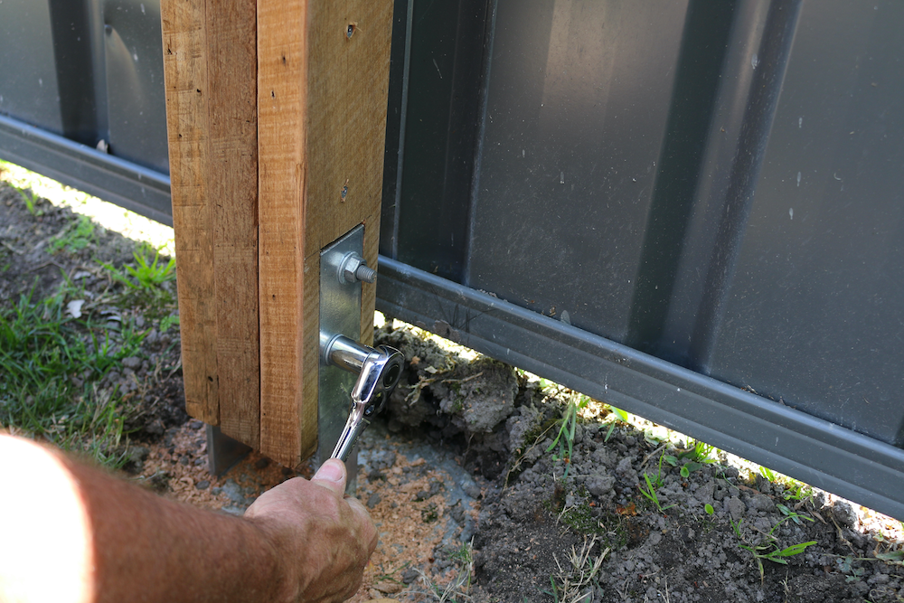

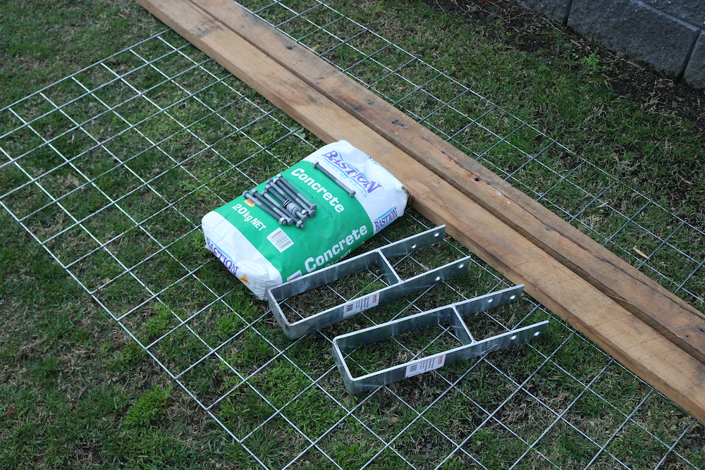

Concrete the post stirrups in place. I've used High Wind Anchor Post Anchors as this is a free standing trellis fence and l don't want to have the posts in the ground as that will make them last longer. Since this is free standing, normal post stirrups don't have enough rigidity to hold the trellis straight over time.
Setting Stirrup to String Line copy.pngStirrups Set to a String Line.pngConcrete Materials.png

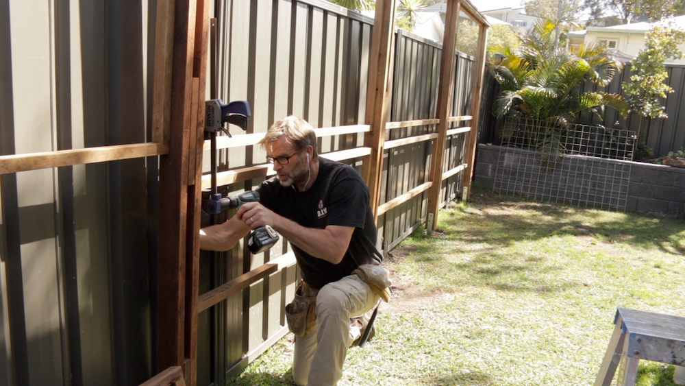

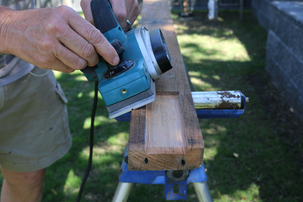

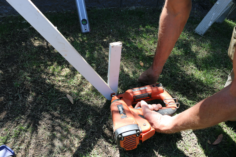

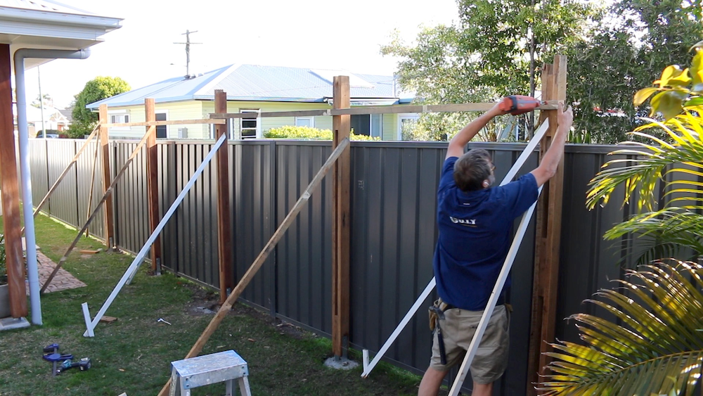

Cut the Posts and bolt them into the Post Stirrups. Make sure you take the edge off the posts to remove any splinters.
Plumb the Posts.pngBrace the Posts.pngTrellis Fence set up .pngArris the Wood.pngDrilling Posts.pngTightening Bolts.png

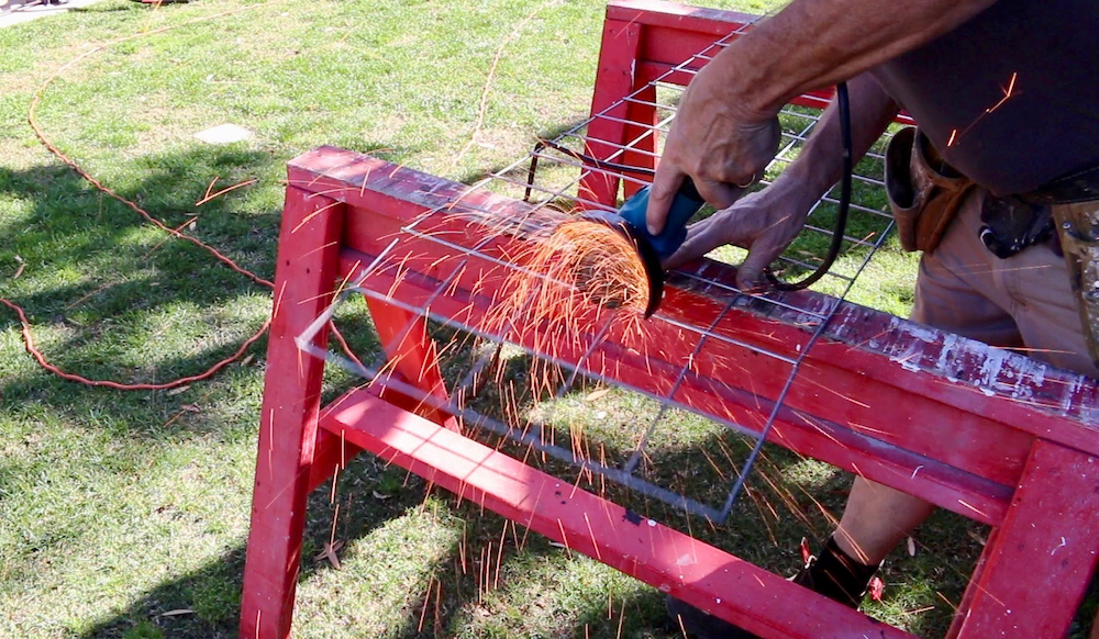

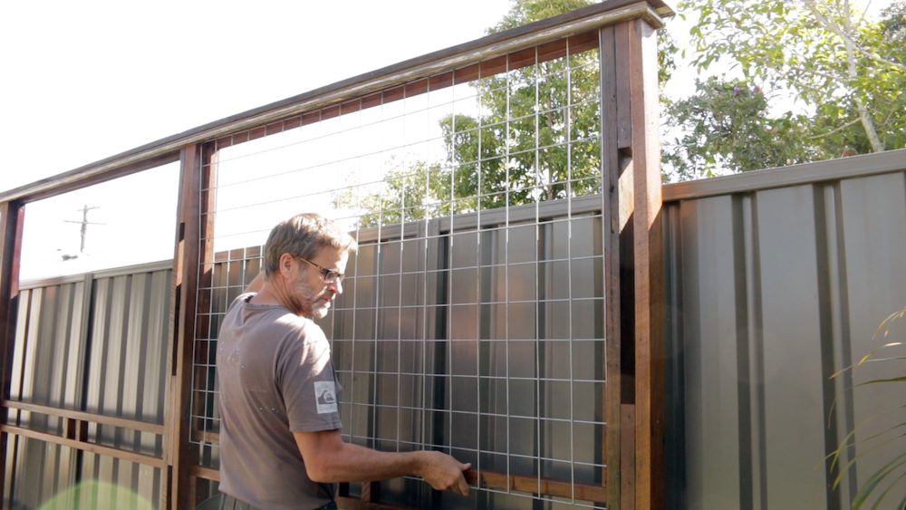

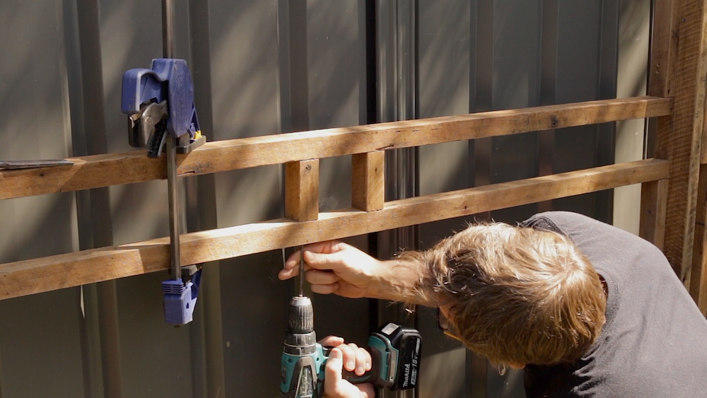

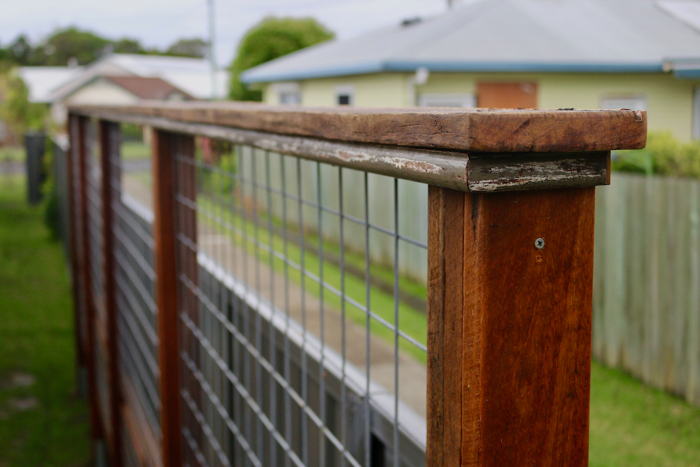

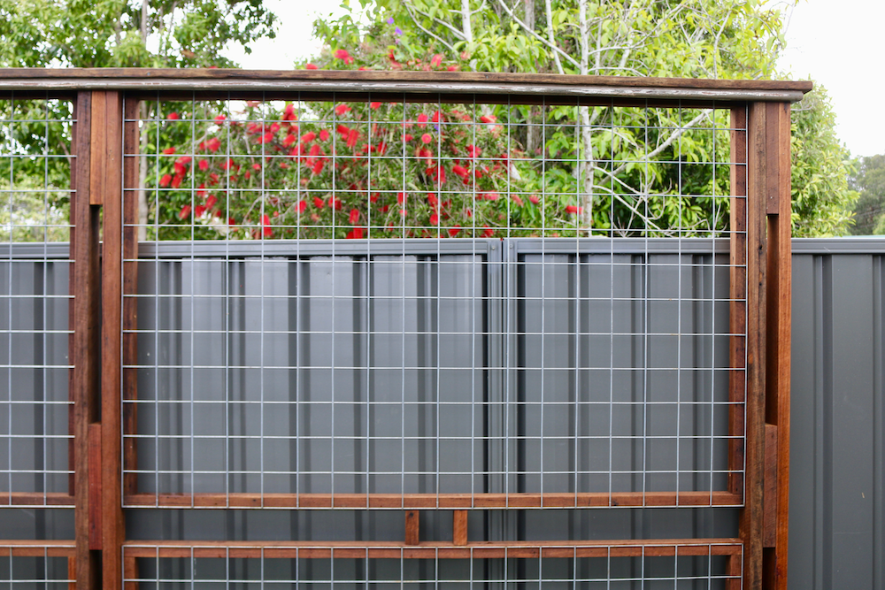

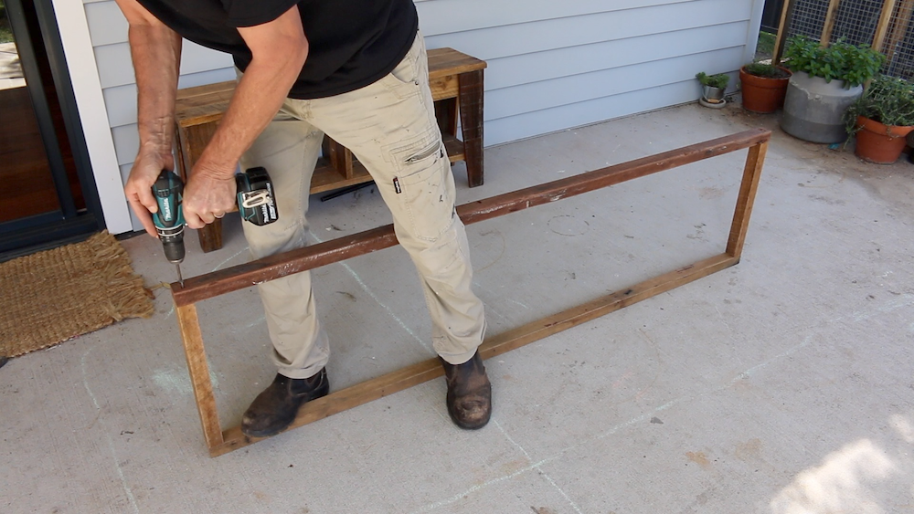

Cut the Frames for between the posts and attach the mesh to the frames using galvanised staples.
Trellis Fence Frame copy.pngTrellis Fence Frame Installation.pngTrellis Mesh.pngCutting the Mesh.png

The job finished, complete with pavers and Cor10 Planter Boxes made to order. Here is the Before and After Comparison.
