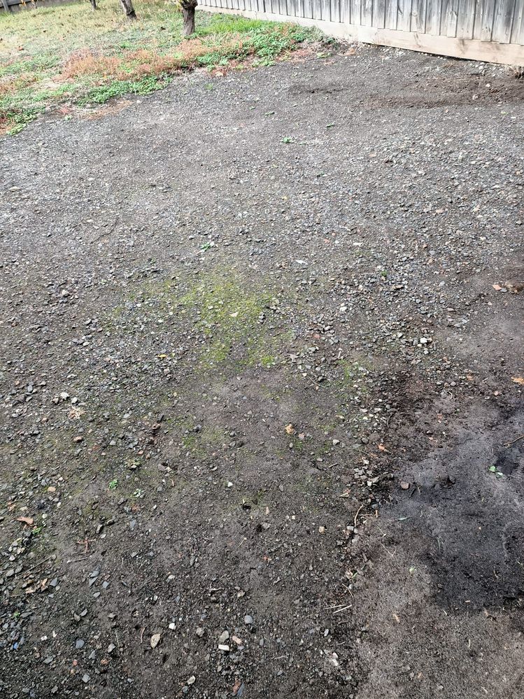

Unfortunately, the slope of the ground moves towards the house and on the left is flat.

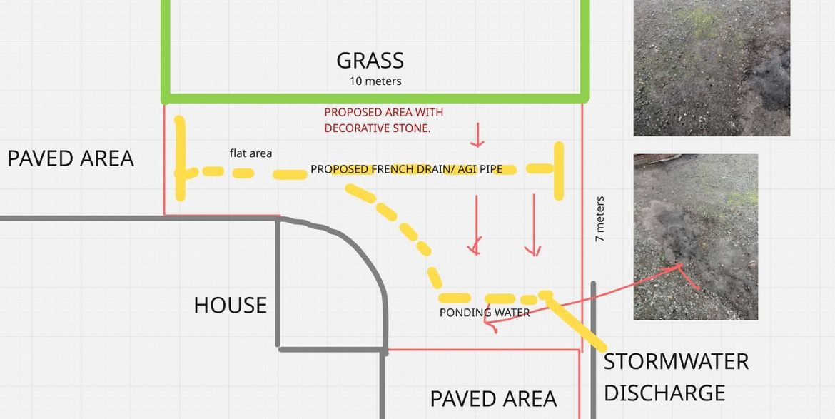

1. Is it better to regrade the slope first before installing drainage? Or do we regrade to where we are planning to add drainage? I understand the first priority is to try to move water away from the house then add needed drainage.
2. What type of back fill/base is best to use to help with the water run off/ away from the house? It will be topped with decorative stones.

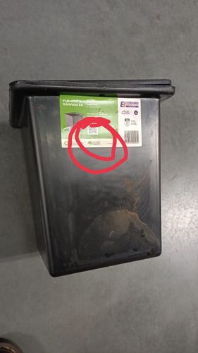

3 As my available storm water discharge is not deep enough to accommodate 100mm agi required trench depth of 300mm.
Will multiple 65mm agi do the job?
4. What is the recommended distance of french/agi drain from the house foundation?

Low area at the bottom right of the pic
4
PONDING AREA

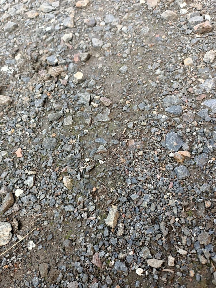

Crushed rocks?

Plan
