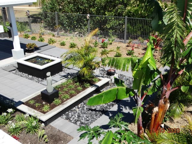

This is our retirement home so it was important that we create a low maintenance backyard that would eventually provide shade for outdoor living in the hot Queensland summer. The design had to include: -
1.Thick planting to screen us from the walkway along the side boundary.
2.Low planting to ensure that we could enjoy the view through the park to the canal.
3.Areas of paving and paths with gravelled drainage areas.
4.A wooden deck.
5.A lily pond with fountain.
6.Pond and garden to be illuminated at night.
7.Vege. garden for salads and herbs.
8.Small lawn area for the dog.

Initially to control the dust the block was covered in turf leaving a 3 metre border which was planted with golden canes, Dracaenas, Cordylines, bananas and pawpaws.

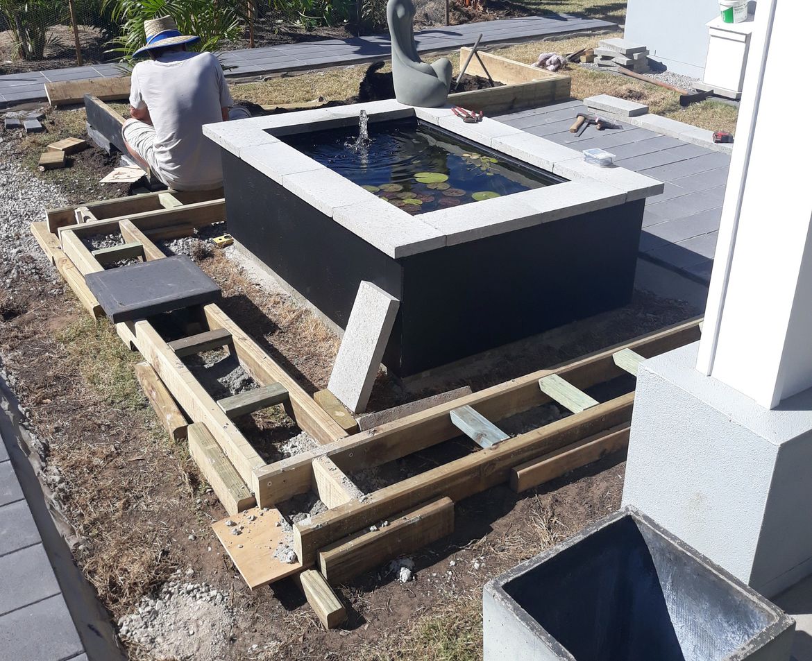

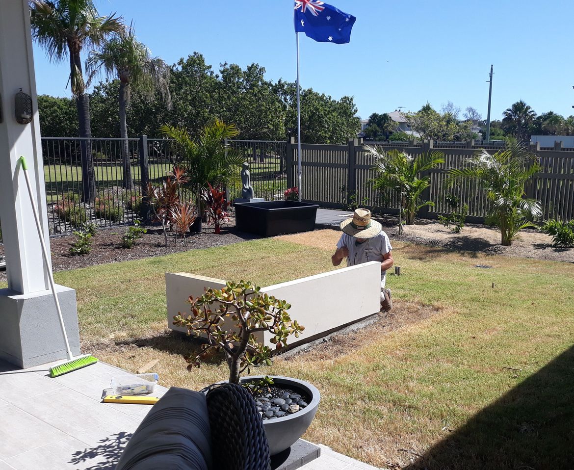

When the weather cooled down, then the work began. A pond was constructed from a treated timber frame covered in fibre cement board which was painted black. A plastic liner was installed and block toppers glued around the perimeter to form seat to sit and feed the fish.

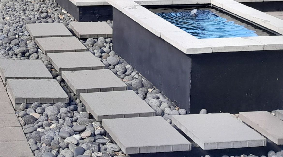

Treated sleepers were used to form a frame for the floating path of 400 x 400 pavers.

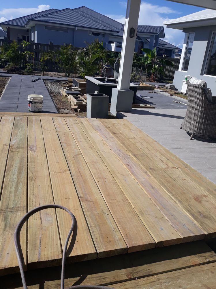

200 x 50 treated sleepers were laid as bearers on the levelled soil. These were then braced and covered in 3 metre sleepers to form a deck. Cheap, quick and sturdy. Once these had dried, they were painted with Cabot's deck paint.

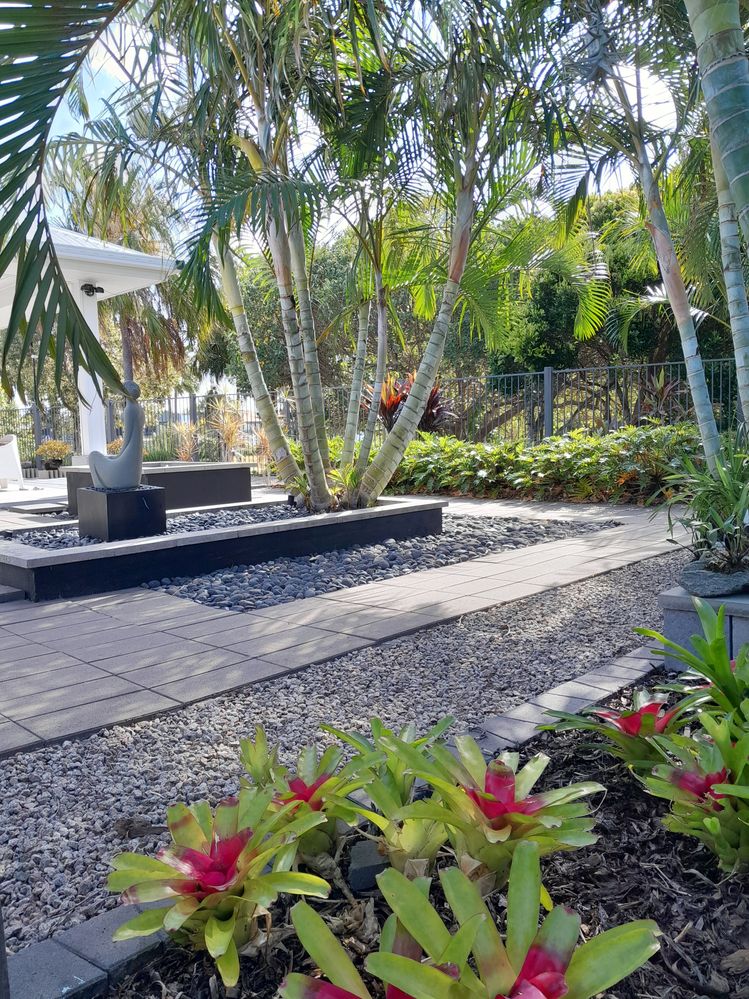

A view of the finished garden. Soon after this photo. was taken most of the plants were destroyed by a tropical hailstorm.

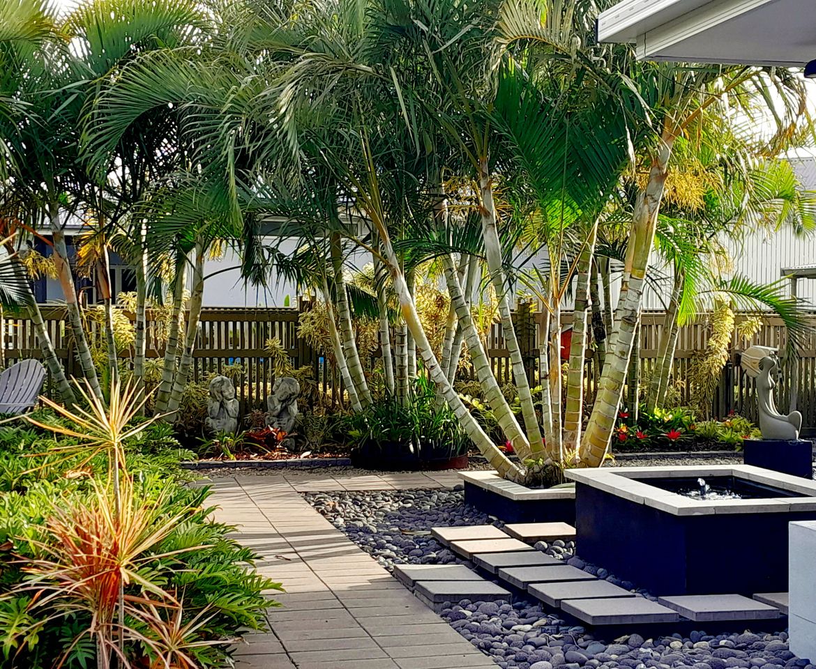

The survivors --- Golden canes with an underplanting of bromeliads and xanadu and cordylines along the park perimeter.

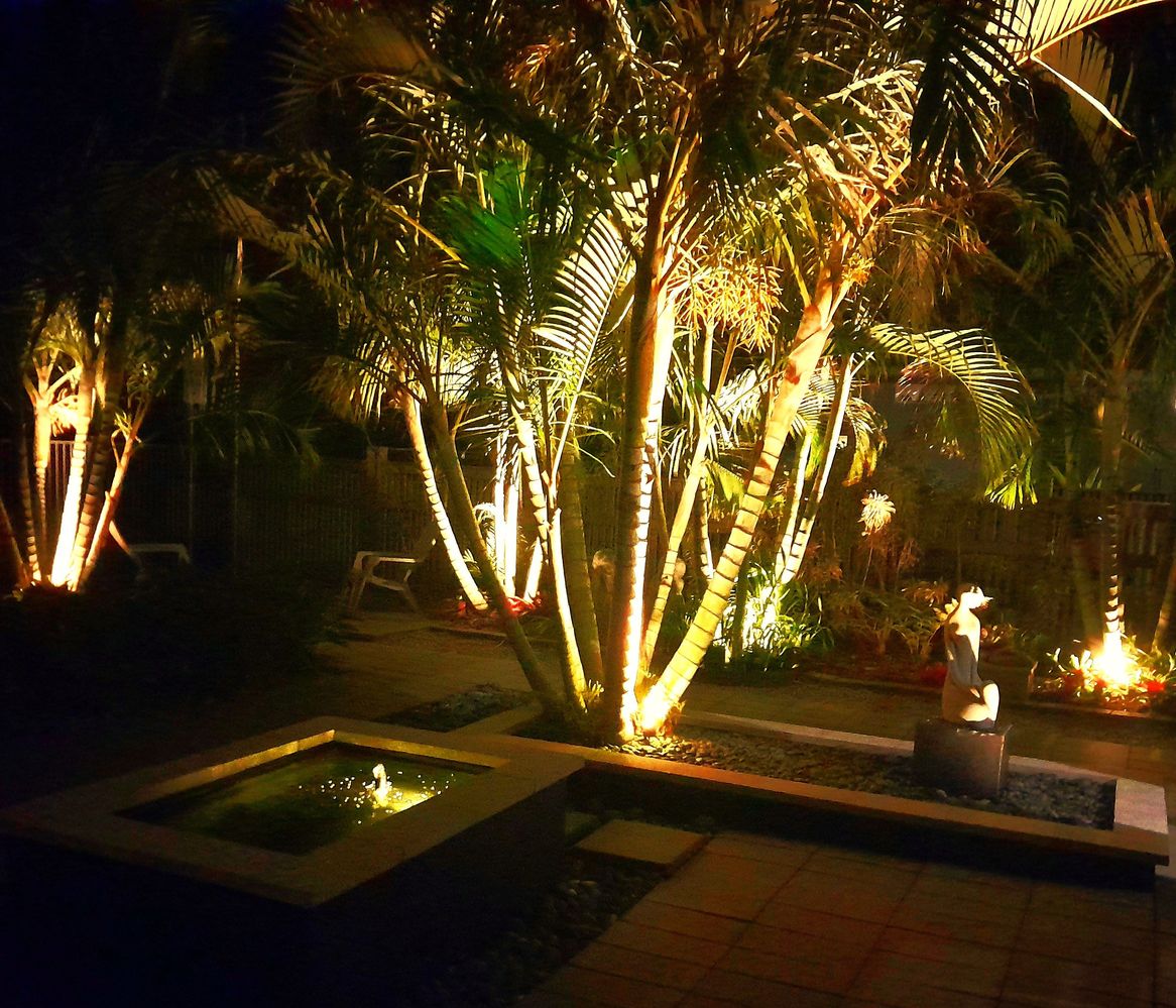

AAn Elluminate spotlight kit was installed to light the garden at night and an Aquapro underwater spotlight in the pond.

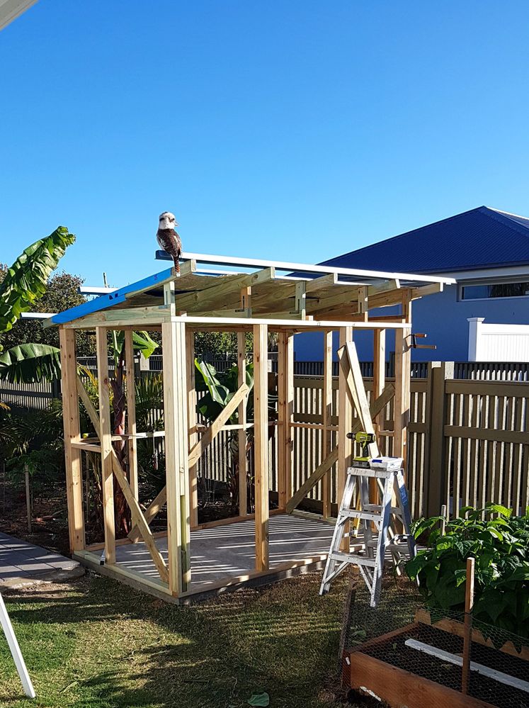

Built a little garden shed with the help of the local kooka burra.

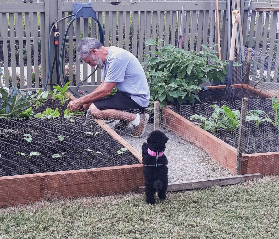

And a vegetable garden with the help of a little puppy.
The first harvest.
Welcome to the Bunnings Workshop community @Alan5. It's fantastic to have you join us, and many thanks for sharing your project.
What a stunning backyard! I really love the way the pond and decking area work together; it creates such a peaceful, resort-style feel. The lighting around the garden must make it magical at night. Well done on creating such a beautiful and relaxing space!
Good Evening @Alan5
Could feel the athmosphere of the yard as soon as I saw that first pic! I am generally not too keen on palms but with your garden it works so well! Love those rounded pebvbles and stepping stones. Did you need to glue them down or are they sitting on the plinth?
It would be a pleasure to come home to.
Morning Dave , thanks for your comments.Yes the papers were glued down with Shelley's landscaping glue.Happy gardening.Alan5
