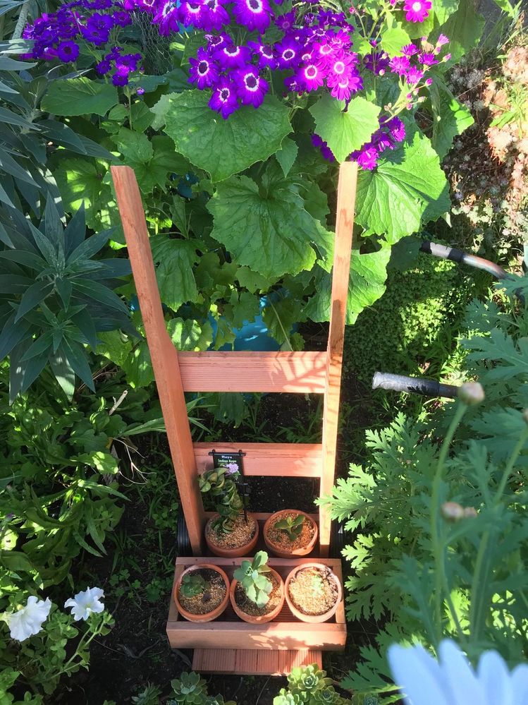

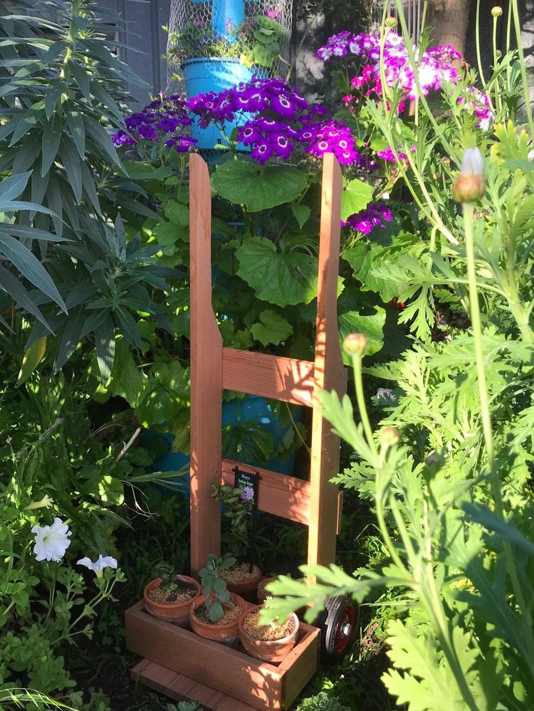

The cineraria in the picture is tall, the sack truck is 1.1metres tall.

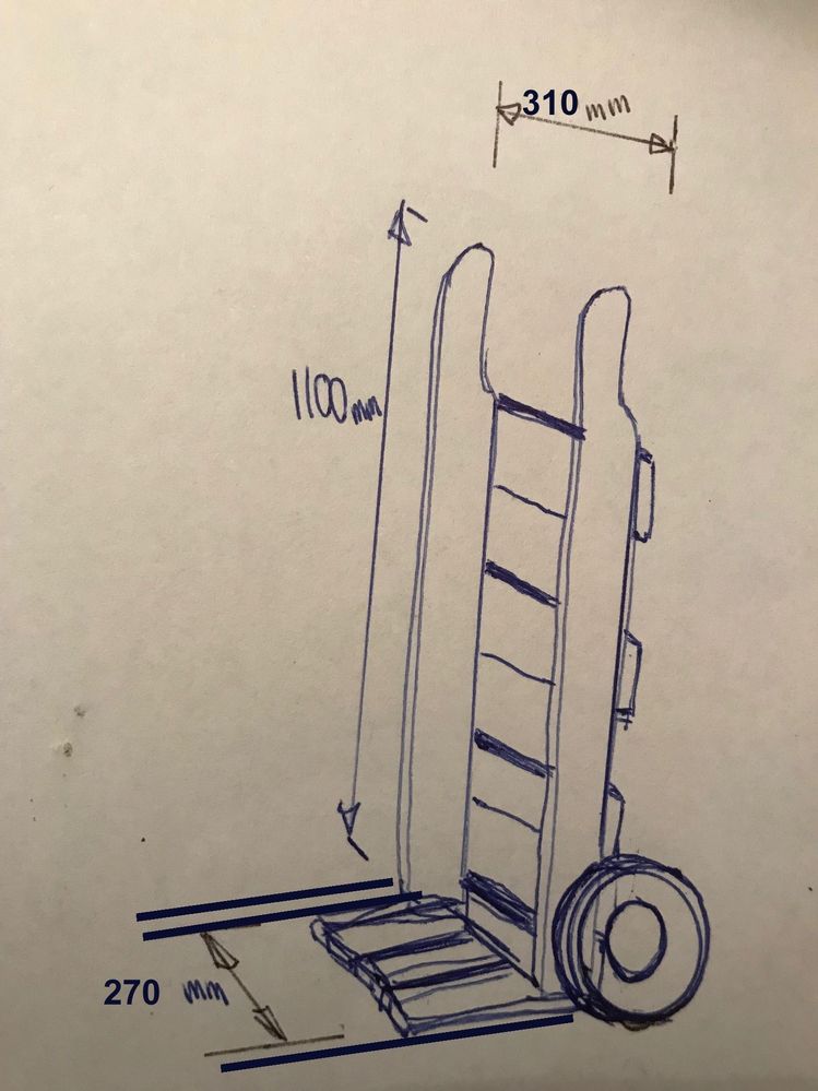

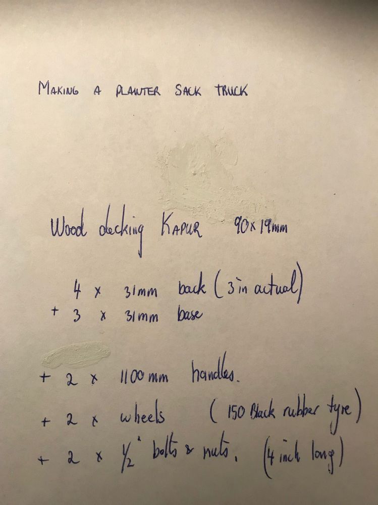

Inside tray measurement is 270mm, for three side by side lengths of wood. Three back rests drawn in, but ran out of wood, hence three in the final version.
