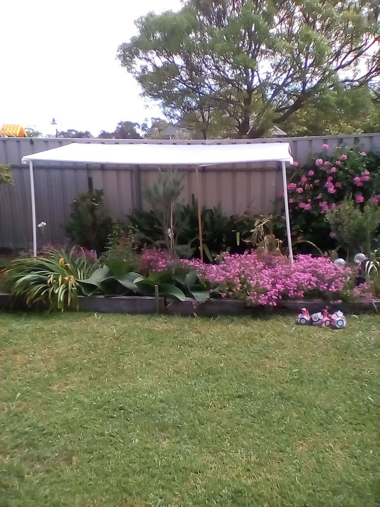

I am really pleased how my shade cloth shelters came out with the help of my son.Now my garden will survive summer.I have one more to make and that will be free standing.
We went to Bunnings and bought all the parts.Just got the white plastic pipe that had fittings It was the thicker one about 3/4 inch.Then got the elbow joints and joiners.We made clips to tension the shade cloth by cutting small lengths of pipe and cutting a slice down the piece and slipping it over to tension and to join it to the eaves we just put a screw into the clip bit and clipped frame in.I used Octupus straps to join to the fence and it works.I added an extra leg to the middle of the second photo after made it strstronJoined to eavesJoined to eavesOriginal structureOriginal structure
