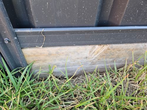

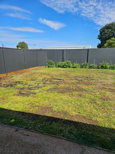

Hello. I was thinking about starting my backyard landscaping and I was
wondering if it is a good idea to put pavers as an edging along the splints of the fence. That corner near the fence is part of the lawn and is just impossible to mow.   
If edging along the fence makes a difference, how do I go about doing it?
Thanks

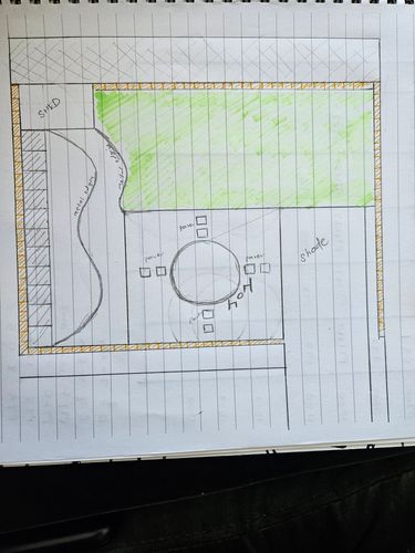

I've had some ideas and have started sketching to explore ideas.
You can see that what I've planned is to border along the 4 sides and that's where I'm planning to do the pavers.
My aim is to give the whole yard some sort of a frame but more so for easy maintenance of the lawn at near the left side of the fence wheres no edging and grass may grow into my neighbour's yard.
It also helps to maintain grass from growing into the pathway close to the house, it has and it is hard to maintain that at the moment.

Nice sketching :smile: Looks like you have a plan and it makes sense with the edging for sure.
