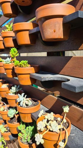

A cheap and easy weekend project that allows you to show off your small succulents.
This project uses 100 mm wide fence palings and 11 cm diameter terracotta pots and a few basic tools, like a drill and a hole saw.
First I cut the palings to length and gave them a bit of a sand. I then worked out how many pots would fit along the length and marked centres for the hole saw. I made sure that the hole I cut was a little more than half of the diameter into the paling to ensure that the pots wouldn't just fall out.
Once all the holes were cut I gave it a paint job and attached it to a timber screen with wing nuts made from scrap wood on the back of the screen.

I used a 100 mm hole saw and start drilling about 20 mm in from the edge to get a secure fit for the 11 cm pots.
