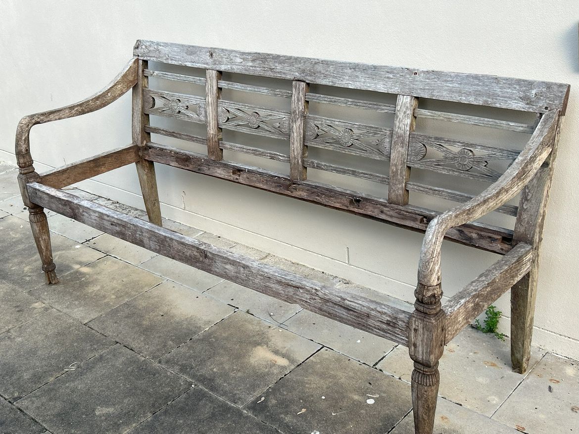

I saw a derelict old garden bench ready for council pick up and asked my husband to collect. His comment was that he had collected a load of old firewood however I ignored that.BenchB.jpg
Step 2
Did a complete inspection and found multiple defects including rot, loose side arm, missing seat and numerous cracks, holes and gaps.

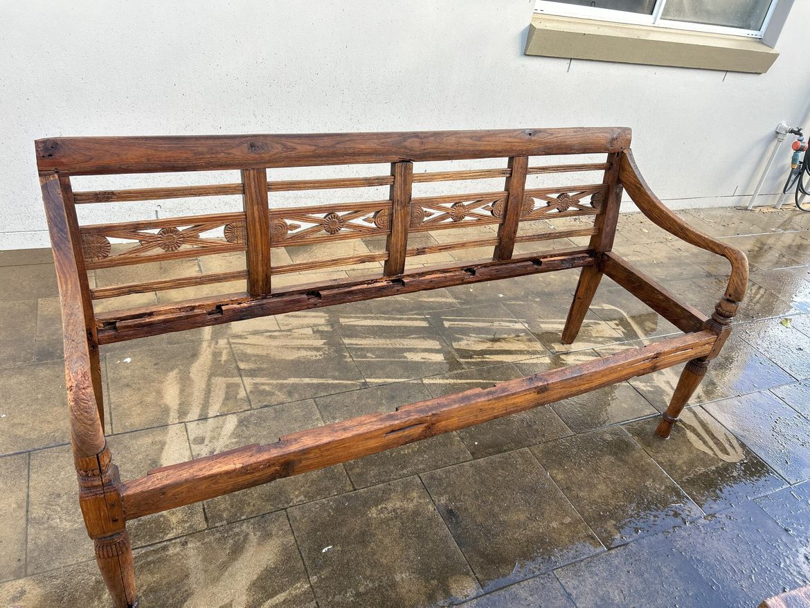

Got out the Gerni and gave it a thorough wash which cleaned off the mould, dirt and fungus. Once dry I gave it two generous coats of boiled linseed oil to put some moisture back into the very dry wood.BenchD.jpg

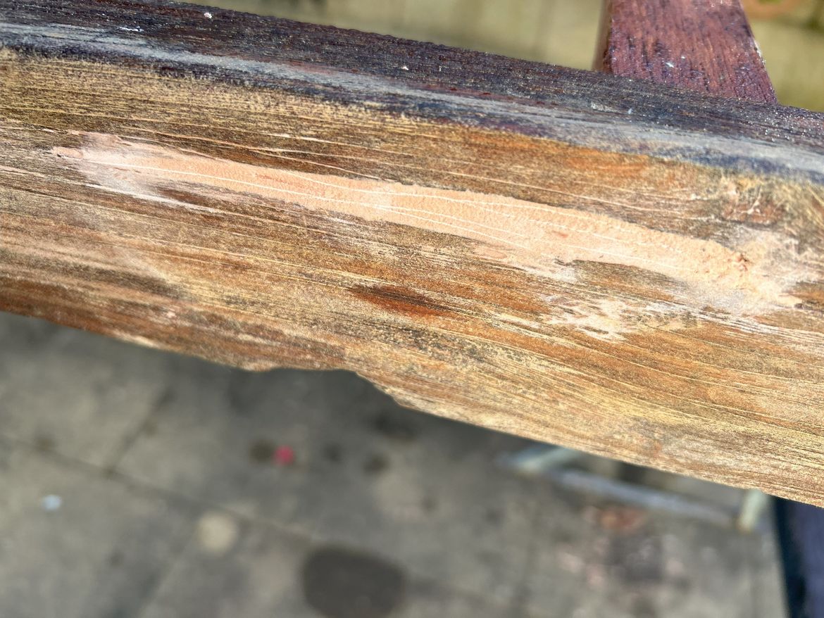

I cleaned out all the rot from numerous holes and cracks which I filled with Turbo Builders Bog and scratched some lines into the bog to imitate the wood grain. I also removed one of the arm supports which was loose, installed new dowels and glued it back into place.BenchG.jpg

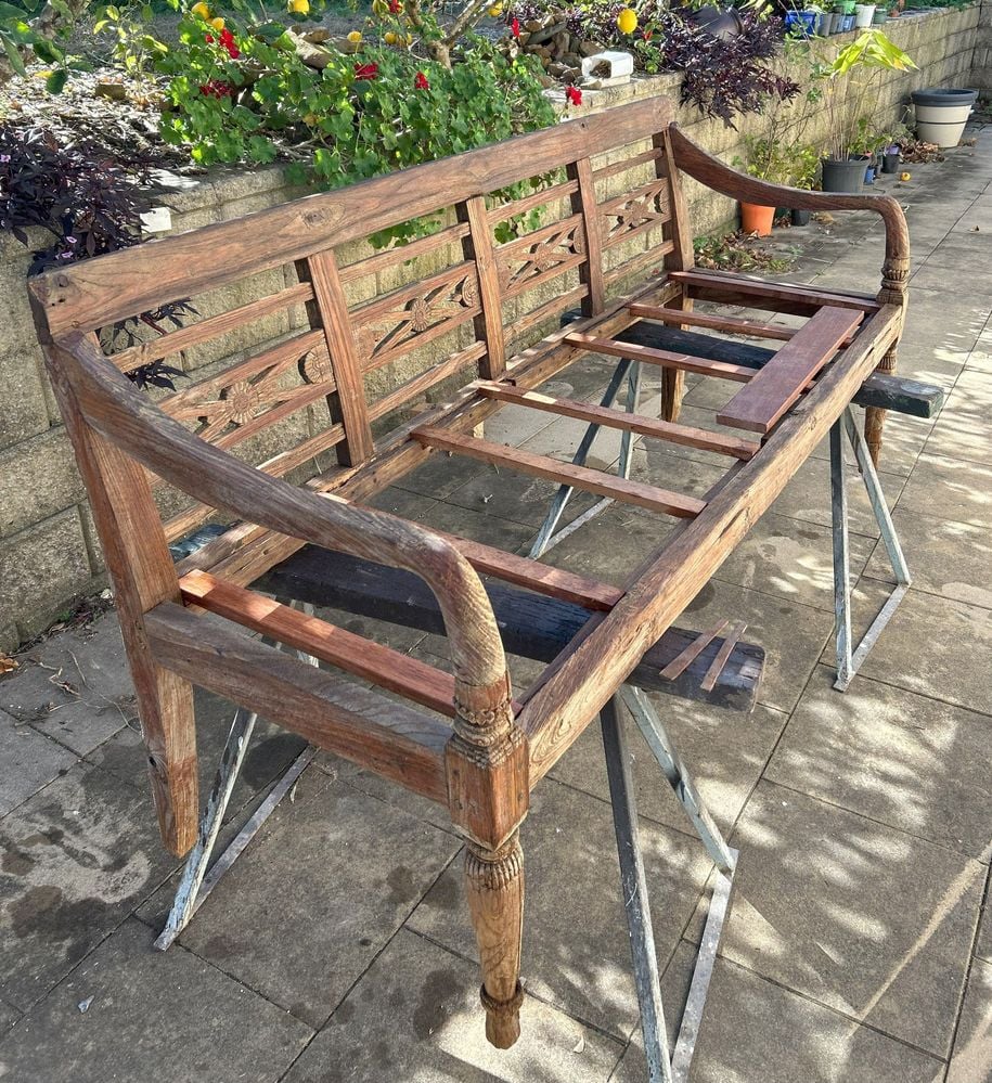

Cut new cross pieces for the bench seat area from pieces of waste merbau and screwed them into place. Measured up for new seat planks and went to Bunnings to buy 1.8m merbau decking.BenchE.jpg

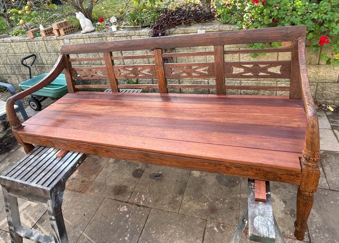

Screwed the new decking planks onto the installed supports from underneath so the screws didn't show.BenchJ.jpg

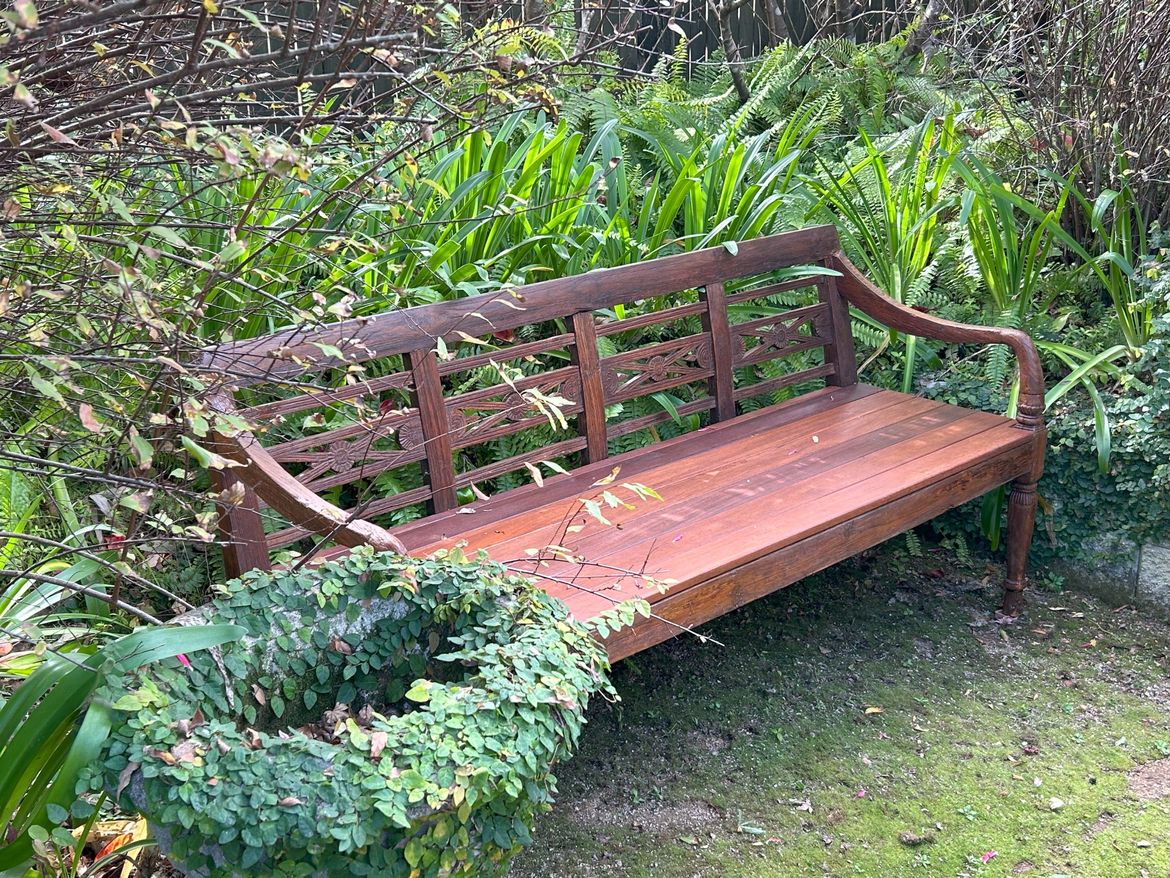

I gave the entire bench two generous coats of Cabots Exterior Stain and Varnish Teak finish and once dry, I moved the bench into the garden ready for relaxing when summer comes. BenchK.jpg

Hi @Milly1,
What a fantastic restoration!
Your garden bench has gone from ready for the scrap heap to a beautiful addition to your yard that will last for years to come.
Thank you for sharing your fantastic project.
