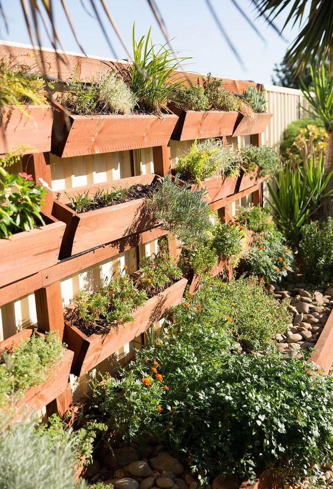

the vertical gardens that i builtthe vertical gardens that i built

Re: the vertical gardens that i built
Looks great! The plants should get enough protection from the high heat that colorbond fences create.
thanks jason,i made 3 of these that are along my fence,and they all have a watering system installed,so now i only have to turn a tap on and my whole garden is watered from my rainwater tank.

hi yorky88
just a few days  to build,if you want to build one yourself i will outline the process .just say you want to fill a 4 metre section, dig 4 post holes 1 metre apart for your uprights.i used 3 metre sleepers that i ripped down the centre.now screw a star picket to the back of each of your uprights,then cement each upright in its post hole with the picket at the back and let setfor the cross beams i also used sleepers ripped down the centre,and bolted these to the uprights,one beam across the top and the other halfway down.i forgot to mention that before i set the uprights,i knotched out  for the cross beams so that sit flush.then for the flower boxes,just measure the gap between each set of beams and make your boxes to that dimension.for the boxes i used 200x25 rough sawn treated pine,which i screwed together to form the boxes.once you have made all your boxes,then just screw them to your upright beams,setting them at an angle.then you can build your base planter box frame and  bolt it to your uprights.give the whole thing a coat of decking oil and you are ready to plant your garden,if you want to add a watering system, i just ran 13mm poly pipe along the top beam and centre beam and added mist sprays. i hope you get a rough idea from this and happy building yorky88

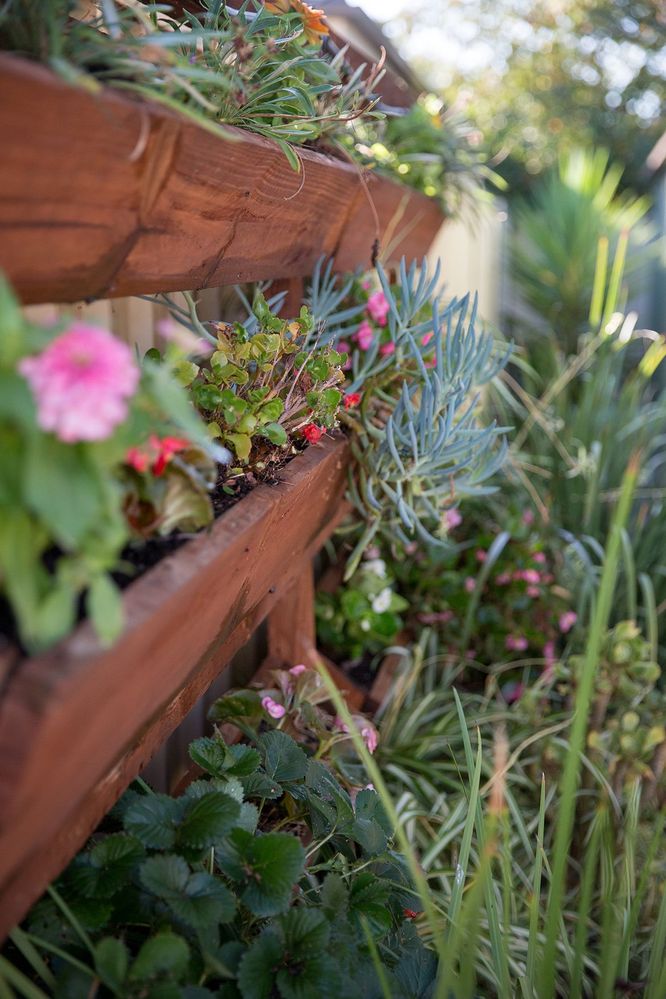

Kel photos
Just wanted to share some additional photos that our photographer took of @kel's wonderful vertical gardens.
