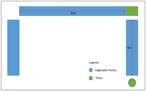

Looking for a watering system to water plants and Trees on scheduled basis. [e.g. every morning / evening for certain time duration]. The layout and dimensions are pictorially represented in below figure. Could you please share of any watering systems for the purpose.

Can you please add where your water source is to the diagram? That will help our members greatly when suggesting the best options.

Hi @nagumuthu Thanks for that diagram, makes it much easier ![]()
The water demands of veggies and trees are very different so I'd be looking a 2-zone system, these type of controllers are easy enough to find an set-up.
Chances are the trees will only really need water during establishment or very dry times a couple of times a week.
