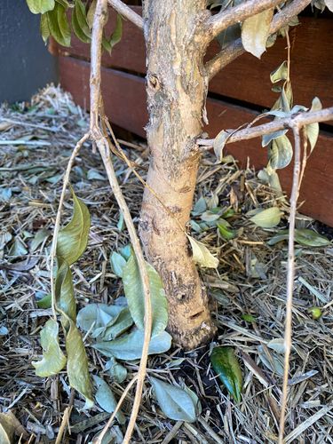

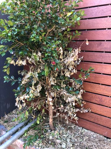

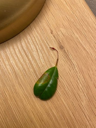

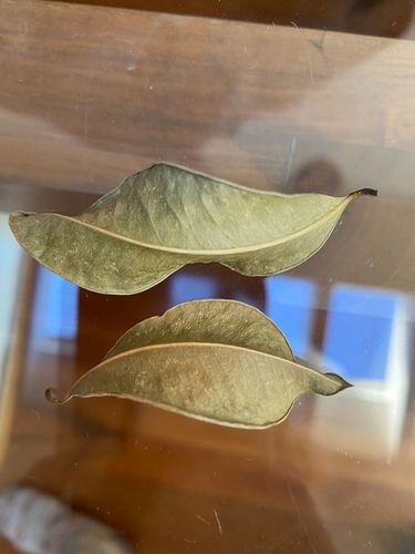

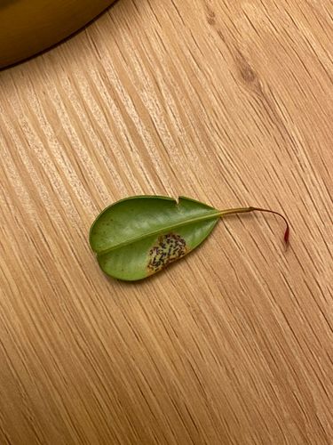

We bought 3x Syzygium australe 'Resilience' - Lilly Pilly back in June 22 and planted all of them in the same location in our backyard. Now one of them is in a really bad condition where other two are completely fine. Attached a couple of photos. We can’t see any insects but made a pic of the leaf as well just in case. Can anybody advise what can be an issue? We treated all 3 same way including watering and feeding. Other two are in a really good condition, just this one which is in 1m apart from the other, is struggling. It’s only like this at the bottom . The top of the tree looks ok. Thank you in advance.

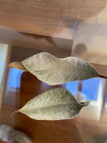

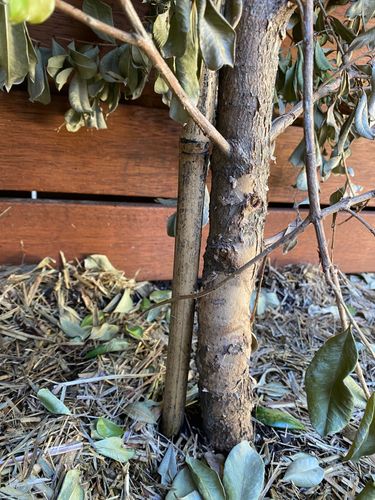

  • Can you please take a photo of one of the dry leaves (back/front) and a picture of the main branch itself? You're looking for discolouration, borer holes and parts of the main branch that have dried up and shrivelled extensively.

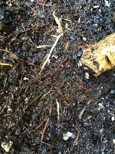

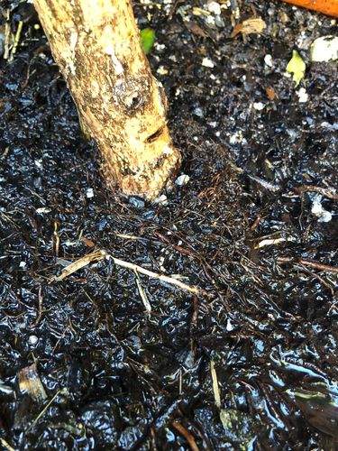

  • Can you please clear the bottom of the tree of leaves and debris, can you dig a hole close to the tree until you see its roots? You're looking for larvae infestation, discoloured black roots, bad fungal smell and water-logged soil.

we digged the hole in the ground as suggested, no signs of larvae.

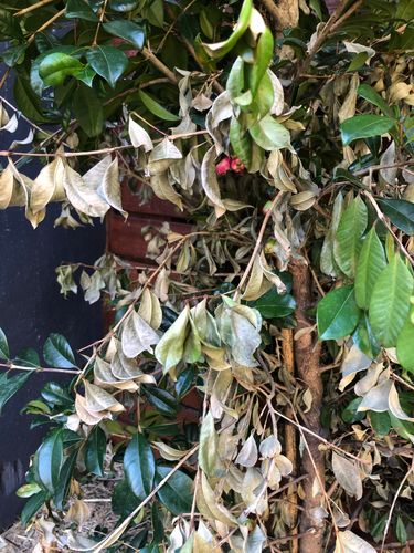

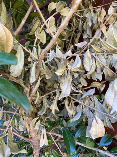

attached more photos of leaves and main branch.

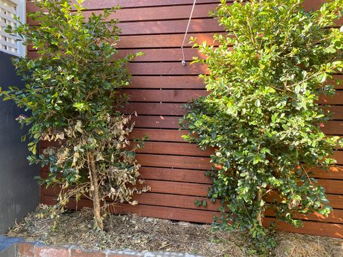

the soil is wet though we don’t water often, may be once a week only. But also attached a photo with issue tree but also just next to it same size tree which is absolutely fine, planted and watered same.
damage began about a month ago after about two weeks after planting.
we are in Syd and it’s very wet all the time with heavy rains over winter. Soil smells as water-logged soil but no fungal smell. Some roots slightly damaged (attached the pic) but just a couple of, otherwise brown.
Lower part of the tree is in shade all the day.

Hi Luba @lovch . Is that water always there? And where does it come from? Is it just rain, or could there be a leaking pipe somewhere?
If the soil stays waterlogged like that permanently it will kill the tree. The roots will just drown and rot. I suspect that those leaves and branches are dying because the roots that supplied them with water and nutrients have died and rotted.
When you dug the holes to put the trees in, was the soil very hard and compacted? If that soil doesn't drain well, rainwater will just be collecting in the hole you planted the tree in. It's best not to water the tree while it's wet like that. I wouldn't water the one next to it, either. That will only add to the problem.
You will need to improve the drainage somehow. Perhaps @EricL can offer you some advice. That brick wall might make things a bit tricky. If all else fails you can grow lillypillies or something else in large planter pots on top of that wall instead.
Can you think of any way to improve the drainage there? Could you post a wider photo of the whole area so we can see that brick wall and any other structures around the area?

Thank you for providing all that extra information about your plant. The good news is that I don't see any type of insect infestation or fungal infection. But I agree with @BradN, it looks like the area is waterlogged and is causing your plant to suffocate as the surrounding water literally uses up all the oxygen available in the soil. I recommend transferring your Lilly Pilly to another location that is not waterlogged. However, due to the damage that has already occurred to the plant, I can't guarantee that it will still recover.
