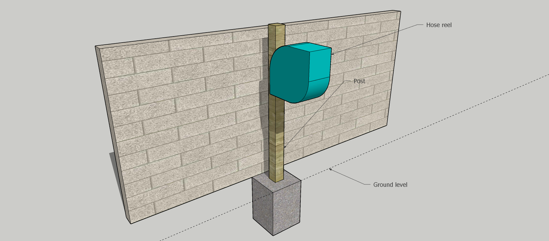

I propose using a 100 x 100mm 2.4m Post H4 Treated Pine Wet CCA - 2.4m for your retractable hose reel. I've placed an image below to give you an idea of how it can be positioned.

So ... with the post, what length would you suggest having it cut to, taking into account the amount that needs to be buried? I understand it is all personal preference (and some people might want the finished post to be say 1.8m high) but I am thinking around 1.0 - 1.2m above the ground would allow for hanging space and not be too low to bend to? But then looking at the pic it does need to have post above the hose ...

I would suggest having at least 400mm of the post buried within the ground, Carol (@cassy1). So, if you aim to achieve a height of 1200mm, the post should be cut at 1600mm. I'd also recommend digging a footer hole of a minimum of 300 x 300 x 400 mm and using at least three bags of concrete in it.
