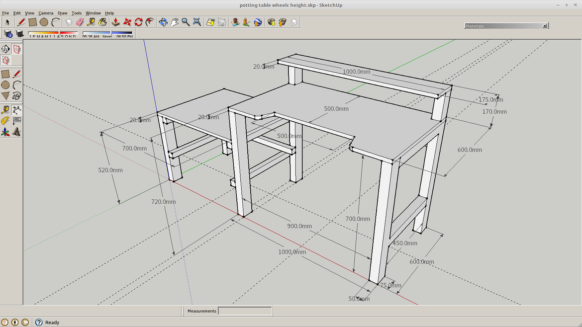

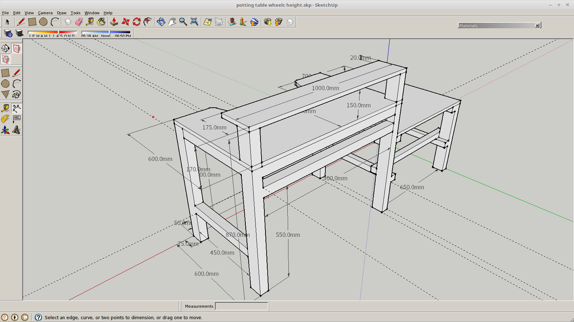

Hello @Hank

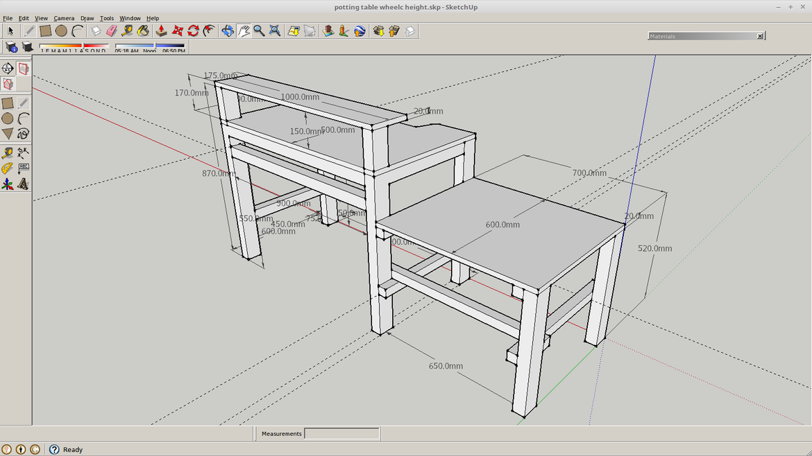

I've drawn you up a plan for a potting table which should be wheel chair compliant. What good is a raised garden bed without a potting table eh? I'm also currently drawing up a purpose built raised garden bed plan that should be compatible with your needs. Just give me a few days to check my measurements. However i would like to ask you a question. How big an area are you dedicating to the garden? It will help me calculate the size of the bed and provide you with enough access around it. The measurements I've indicated on the plan are based on standard timber sizes available at Bunnings. A handy DIY person should have no problems following the plan I've draw out for you. I strongly suggest treated timber for the legs and at least a hard waxed or pre-oiled timber bench top for your table. An extra coating of wax or oil all over would'nt hurt either. This should protect it from the elements and give a long service life. The lower table at the side is for the landing of the soil and plants and you have your prep area which if my numbers are correct should be just above your legs. But please feel free to correct these numbers to suit your needs.
I had to take out the color so you would see all the numbers.I had to take out the color so you would see all the numbers.
 Here's the view from the back.Here's the view from the back.A better view of the landing.A better view of the landing.

Thank you so much for that idea and drawing, I think we will build that or get it built.
Hank
Getting Established
Re: Wheelchair accessible garden boxes
Further to your post, we are only thinkiing about a metre by 50 cm as our back yard.:smile: is fairly small and we only want it for herbs. Yes, 700 mm is a good height. :rosy:

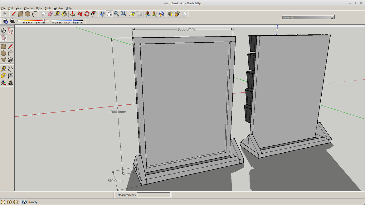

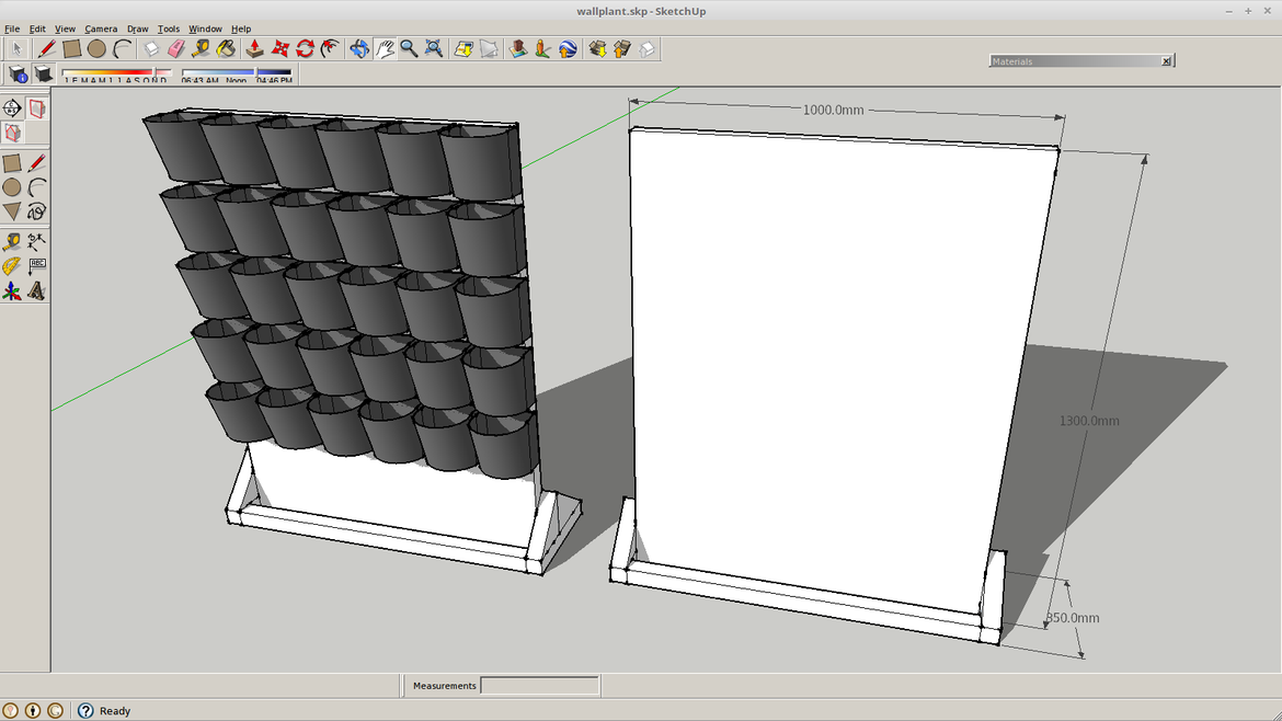

Hello @Hank

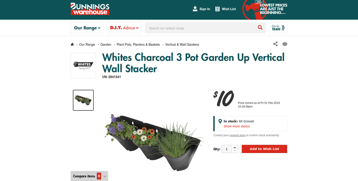

As promised here is my suggestion for your raised garden bed. Due to the limited space available to you I was turning this issue in my head, why not a vertical planter! Not only will you have more planting space it can be tailor made to your reach! I've read some articles relating to vertical reach and have made the appropriate changes to my plans, as always please adjust to your needs. The wall mounting unit you see is basicly a frame with 12mm marine ply in front of it. This will allow you to drill into the ply and hang the garden pots from it. If possible you can choose to have the frame built and mounted to the nearest accessible wall. If not possible simply have the legs built according to plan. Please note that I have made the legs longer at the back to allow you to place a bag of sand as ballast to prevent the wall from tipping. I have used  this particular wall hanging pot as an example.
It was the first cheapest wall hanging plastic pot I could find.It was the first cheapest wall hanging plastic pot I could find.
I've made the timber wall big enough to take 10 of these pots. It should provide you with a lot of planting space not only for herbs but other plants as well. I've limited the height of the wall to 1.3 meters, but should shoulder strength be an issue you can make the wall lower. Just use the pot as a measuring guide as to how high you want the mounting wall. There are many examples of vertical gardening, if you have access to the internet it will show you a wealth of ideas on choices of plants and type of pots to use. If you would like the plans to be amended please send me a message here in the workshop community and I will re draw the plans as soon as time permits. I hope these ideas helped and wish you the best of luck in your gardening plans.
Just to let you know, those pots can be unhooked and serviced on your potting table.
One with the pots installed and one without, you can have more side by side.One with the pots installed and one without, you can have more side by side.The bag of sand goes at the back.The bag of sand goes at the back.
