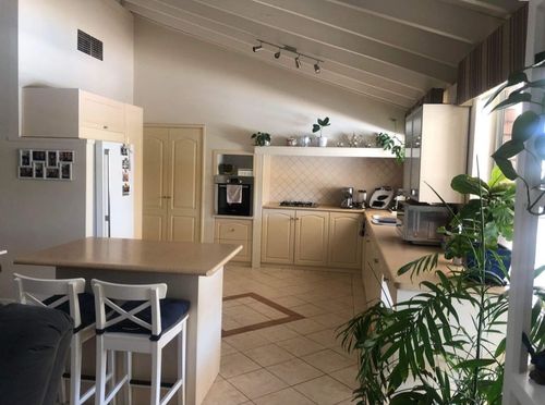

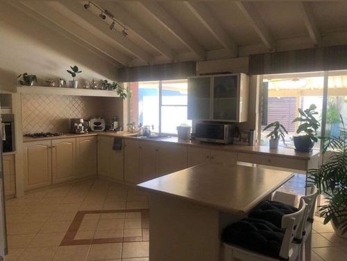

Before shot
Step 8
Before shot

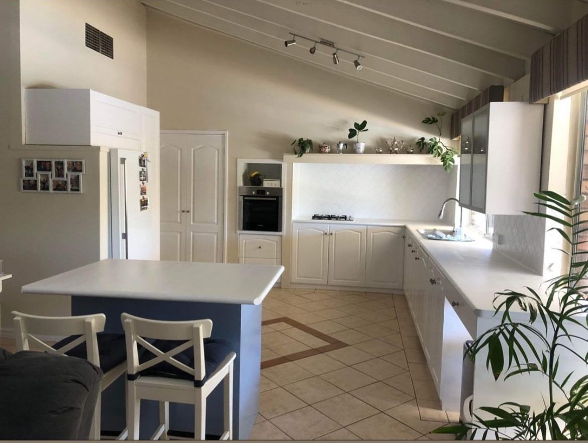

Step 9
After shot

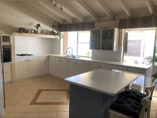

Step 10
After shot
