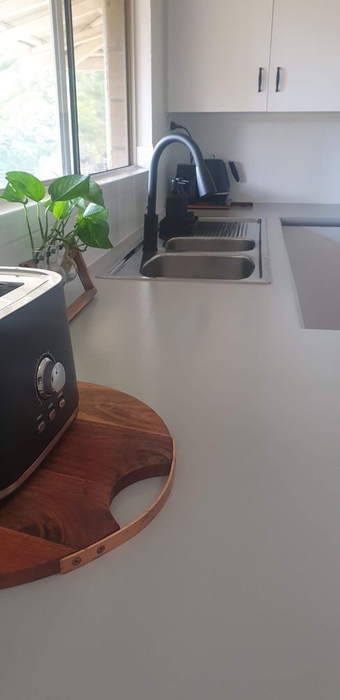

I used the benchtop range in Flooded Gum colour. I used the cupboard paint in Lexicon Quarter as well.
I changed the door handles to a modern black hardware. I changed the mixer tap to a black pull out spray version.

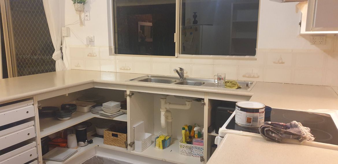

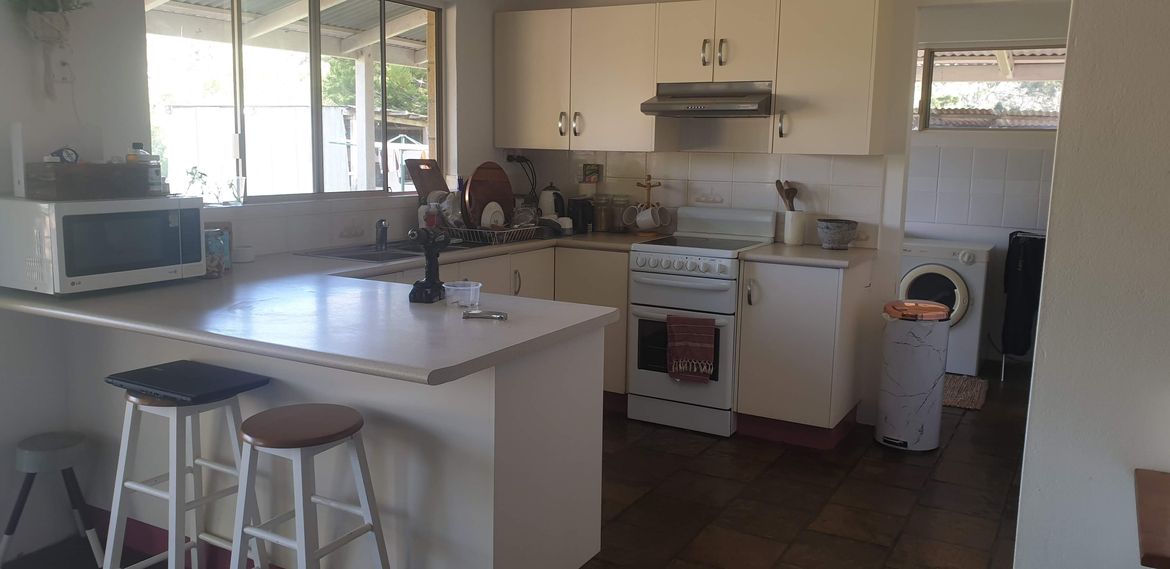

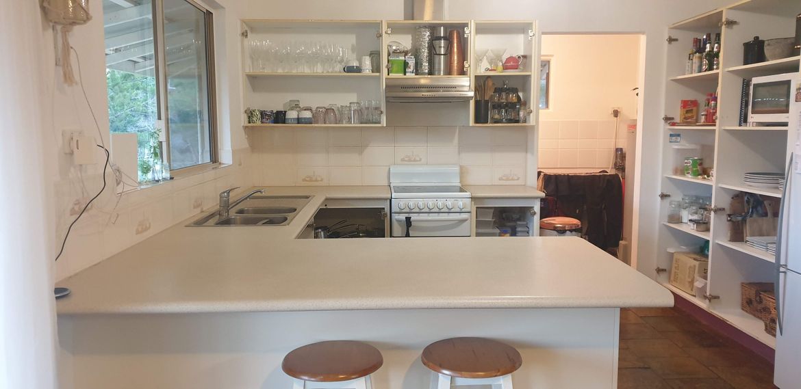

This is the before photo of the kitchen. It had cream cupboards, cream and brown pitcture tiles, maroon kickboards and a cream fleck benchtop.

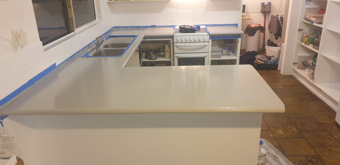

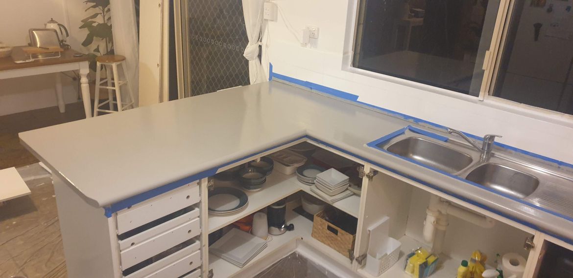

First step was taking all the cupboard and drawer fronts off. I then used sugar soap and cleaned these all once laid out on the floor. I also cleaned the tiles and benchtop thoroughly with sugar soap three times over and taped up all the areas using the Scotch blue tape

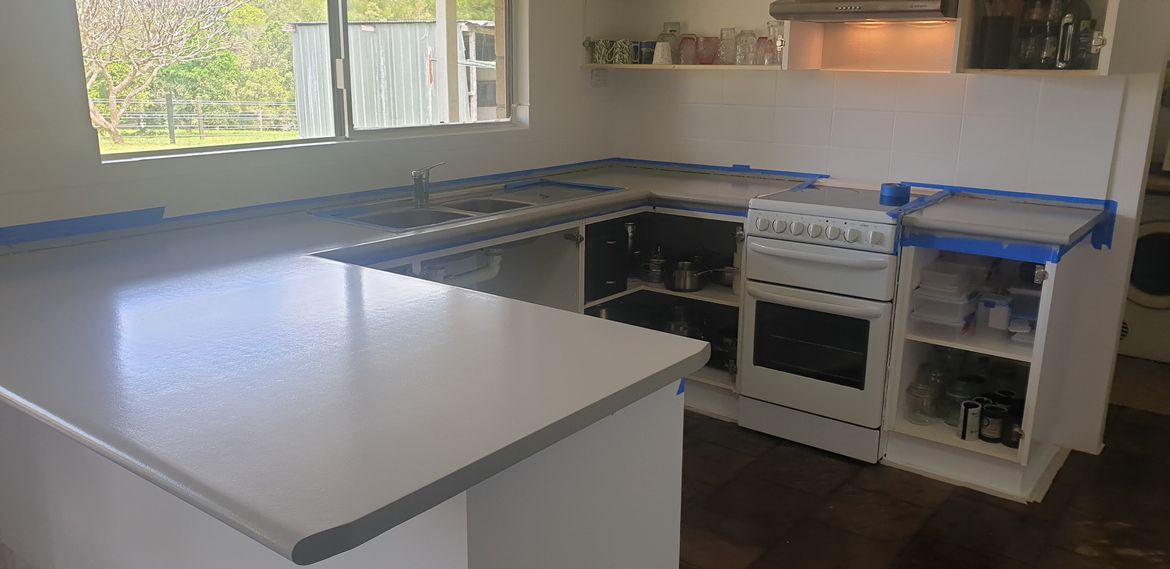

I painted the tiles first with a roller and then painted the benchtop. I lightly sanded the tiles and benchtop first to rough the surface up to ensure the paint had the best ability to stick. I was already so happy with how it was looking.

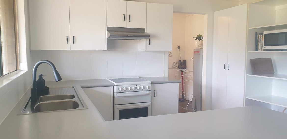

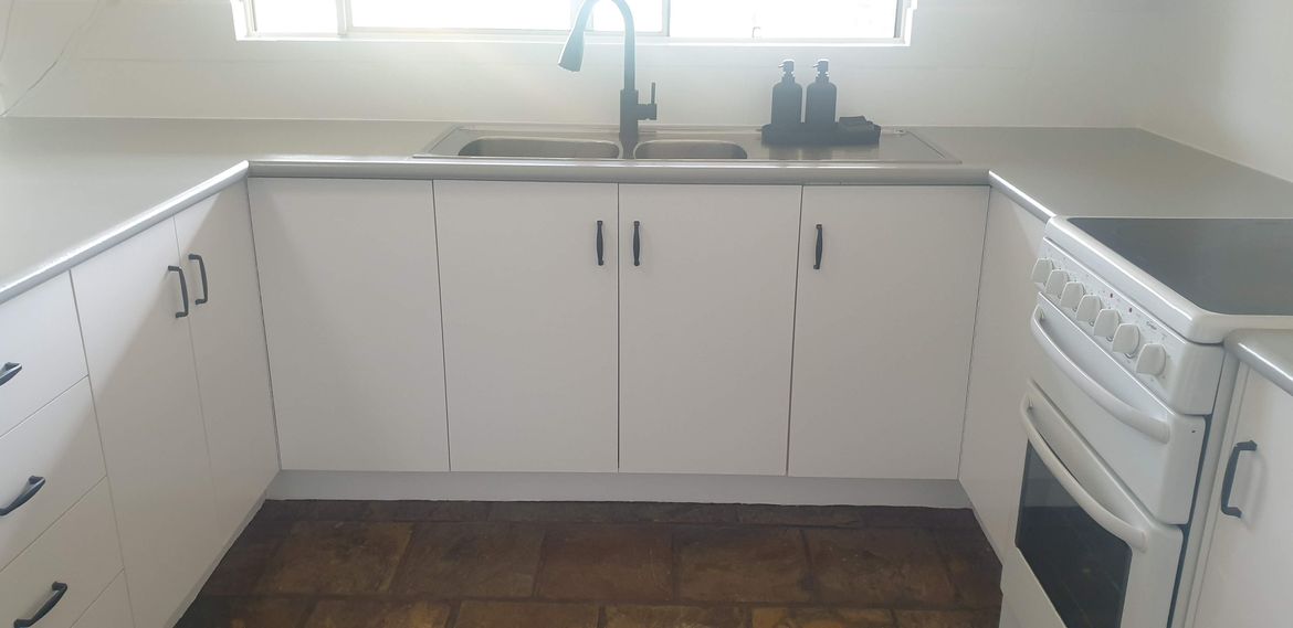

I changed the tap to a black mixer

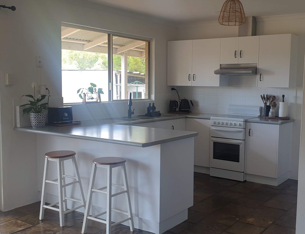

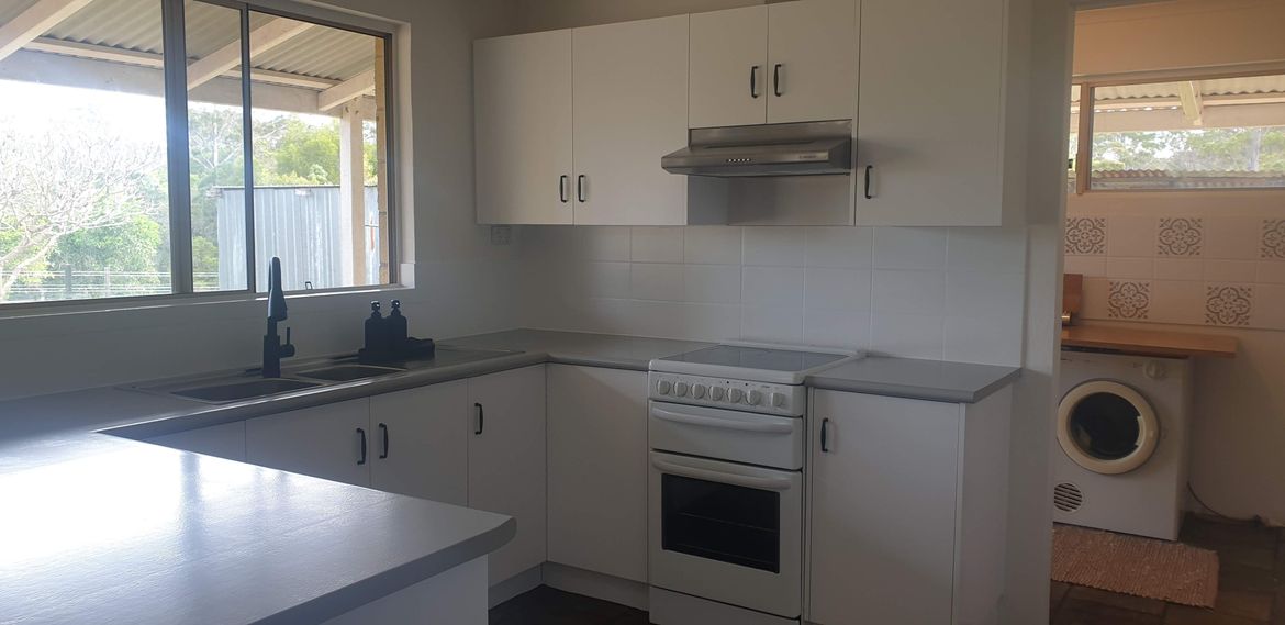

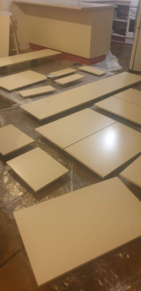

I painted all the cupboards when on the ground in three coats of the Dulux Renovation range cabinet doors paint. Then I left them for 7 days to cure. The benchtop was also left to cure for 7 days. Once cured, I put all the cupboards and drawer fronts back on with their new handles.
I am absolutely over the moon with the finished result.
