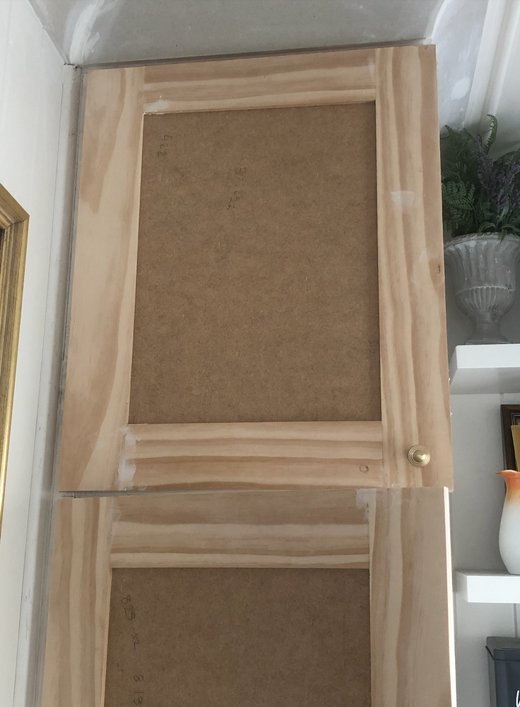

Hi there, I'm wondering if anyone has used Zinseer BIN as a primer under aquaenamel before? I've made some doors for my laundry cupbboard out of pine and mdf (don't judge me, they're my first attempt at anything like this haha) and I am wanting to paint them soon and I already own Zinseer BIN so I was wondering if I could use that rather than Dulux PRECISION Stain, Smoke & Odour Blocker. Also, is Aquaenamel the best choice for a kitchen area?
