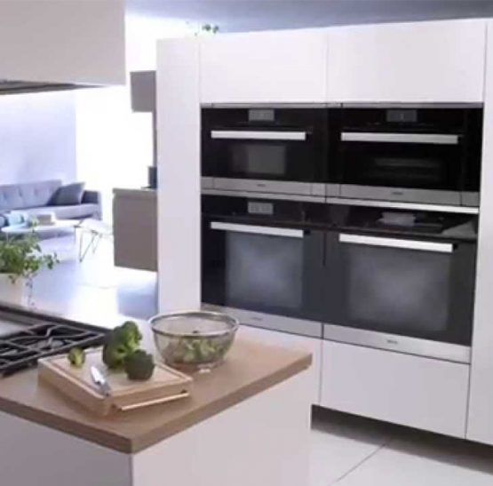

I am looking to hopefully do something similar to this image of the Miele appliances in my renovation project using Kaboodle kitchen products, but am not sure I can do it.
Let's assume the following conditions;
- It will consist of 2 columns (or in Kaboodle terms 'towers')
- I don't want anything showing between the appliances hence can't just stick 2 oven towers together (but hoping to somehow combine them and still be structurally sound and able to handle the heat)
- Only want the outer panels on the outside of the 2 columns (none in the middle as would be needed to achieve gaps between appliances)
- Column 1 will have built-in microwave, steam oven and vacuum seal draw (all of which can't be boxed, I believe)
- Column 2 will have built-in coffee machine, oven and warming drawer (all of which can't be be boxed, I believe)
- Not sure if can have any horizontal pieces without them being visible.
- Height requirement of these are 455 then 596 then 141 in respective order and base on a Miele example (not sure which brand I will be using yet)
- All to to suit a 600 space having 595 in the dimensions spec.
- Note there is a decent difference in the heights I need and what comes with the tower kit.
Note that I am aware that I listed 3 built-in appliances in each column/tower and the image only has 2 of these.
Would anyone be able to help me understand how I would be able to achieve such a configuration using the Kaboodle products, if it is even possible?

Before I make any recommendations, would it be possible for you to post the make and model of your oven? I have seen it done with the 600mm oven towers, but I will have to ask Kaboolde if it can be done with larger appliances such as a double 900mm oven. I've always placed spacers in my kitchen design as a form of insulation. I will have to confer with our provider to make sure it is safe to have oven towers next to each other without the finishing panel.

a) putting them side-by-side without the 2 pantry panels (as I like them to look like the Miele photo attached in the original post)
b) getting the right cabinets/draws included to get that height
Thanks, I look forward to reading your comments.

Thank you for providing the make and model of your appliances. I've spoken to Kaboodle and I've been informed that the oven tower is only for a single stand-alone installation. They are not built for side-by-side installation, even with the insulation panels. I've also called Bosch and they were not able to provide any guides concerning oven tower cabinets. I will be calling another department of Bosch on Monday, they may have more information concerning oven tower cabinets. I'll get back to you as soon as I have more information.
I've made a diagram below of what it might look like once you have the Bosch appliances installed. For illustration purposes, I've based the measurements on default flatpack cabinetry. If you were to engage the services of a professional kitchen cabinet maker, you could have this particular section custom-built. I will ask my colleagues at other stores and see if they've made designs with double oven towers side by side.
