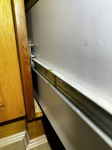

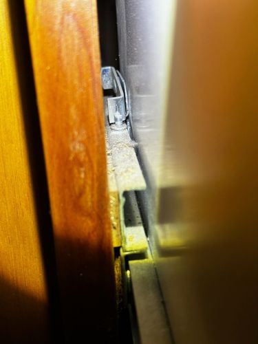

I have an old kitchen with one of the drawer recently damaged and needs repaired. However I have no luck to take the drawer out because I have never see this type of drawer track before.
It would be really appreciate if anyone can let me know what kind of track is this and how can I take the drawer out completely.

Hi @rickiel
Good photos
these draws must have some sort of release to have installed them in fisrt place.

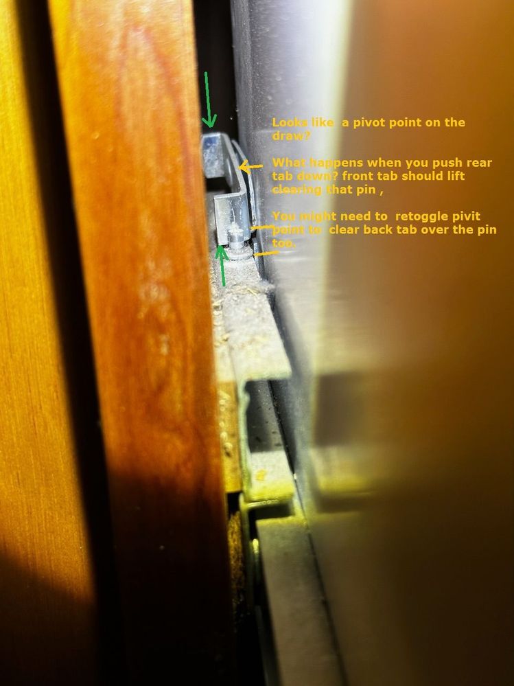

In your photos I think i am seeing a pin stopping the draw coming out and a pivit point with double lugs you may need to toggle to remove draw most likly on both sides of draws.Pivit point and blocking pin?

It's fantastic that you've received good advice from @Jewelleryrescue. Tipping the pivot locking pin up and over is exactly what you need to do in order to remove the drawer from the kitchen cabinet. It is a similar version of the Syneco 400mm White Drawer Slides except your one has a locking piece attached to it.
I suggest bringing the entire drawer runner set to the store so that you can compare its thickness to modern drawer runners. It's important they are the same so that they will fit into the current gap between the cabinet and the drawer.
