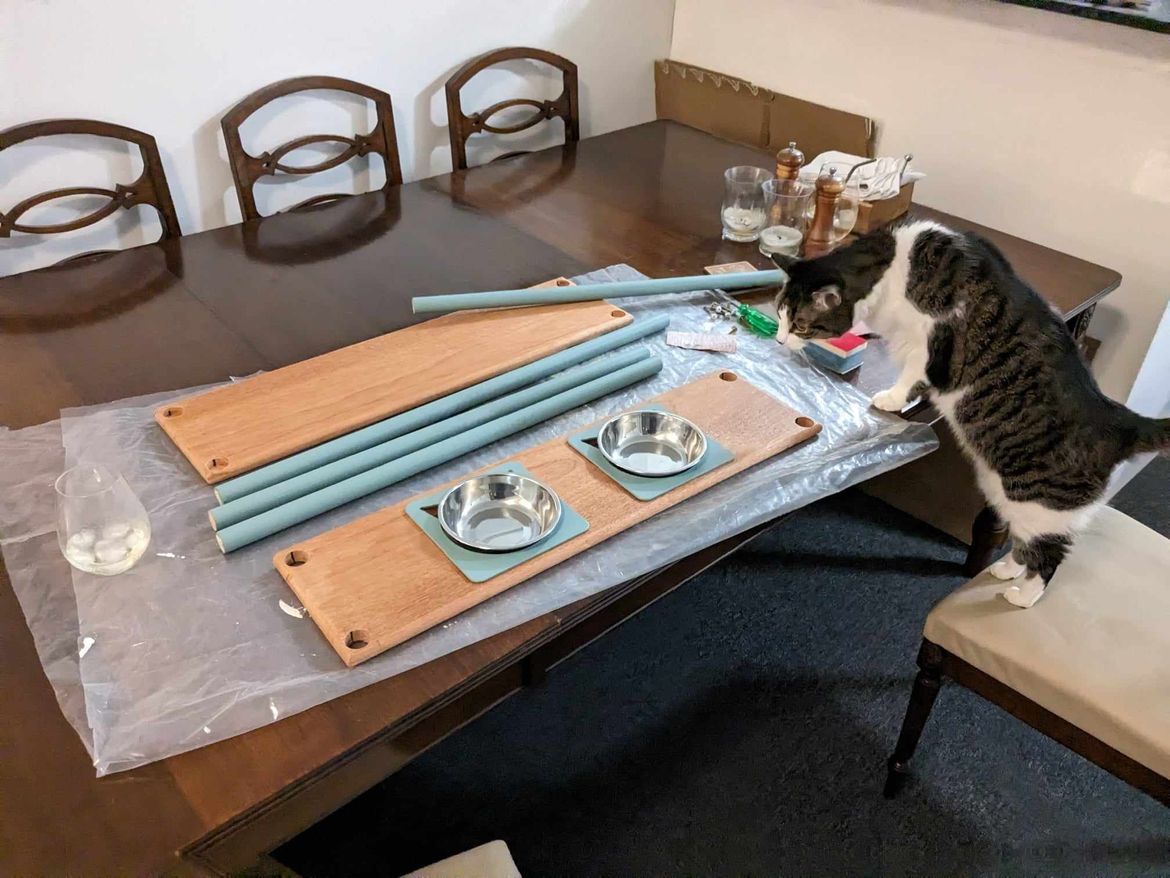

We started by finding a pair of metal pet feeding bowls from the new Bunnings pet selection. Based on the size of the bowls, we drew up a design and bought a 185x19x1800mm piece of DAR Tasmanian oak and a 1200x25.4mm dowel to form shelves and legs.
Our key design elements, consisting of upper and lower shelves, legs and bowlsOur key design elements, consisting of upper and lower shelves, legs and bowls
Step 2
We cut the Tasmanian Oak board into 750mm long upper and lower shelves using an Ozito circular saw. Since it will live in the kitchen and we don’t want sharp edges, we rounded off the edges with an Ozito laminate trimmer. Using an Ozito mitre saw, we then trimmed the dowels down to size to function as legs, keeping the back legs shorter than the front legs to account for our skirting boards.

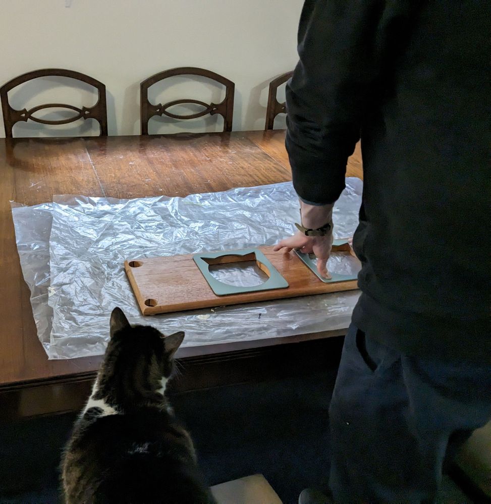

We wanted the bowl cutouts to have finger holes for easy feeding and cleaning, and thought doing them in the shape of cat ears would be super cute. We used a Ryobi jigsaw to cut a 130mm diameter for the bowls to sit in and little triangular ears for the finger holes.

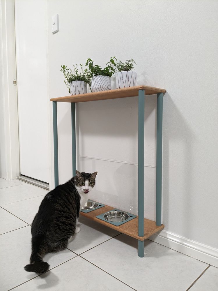

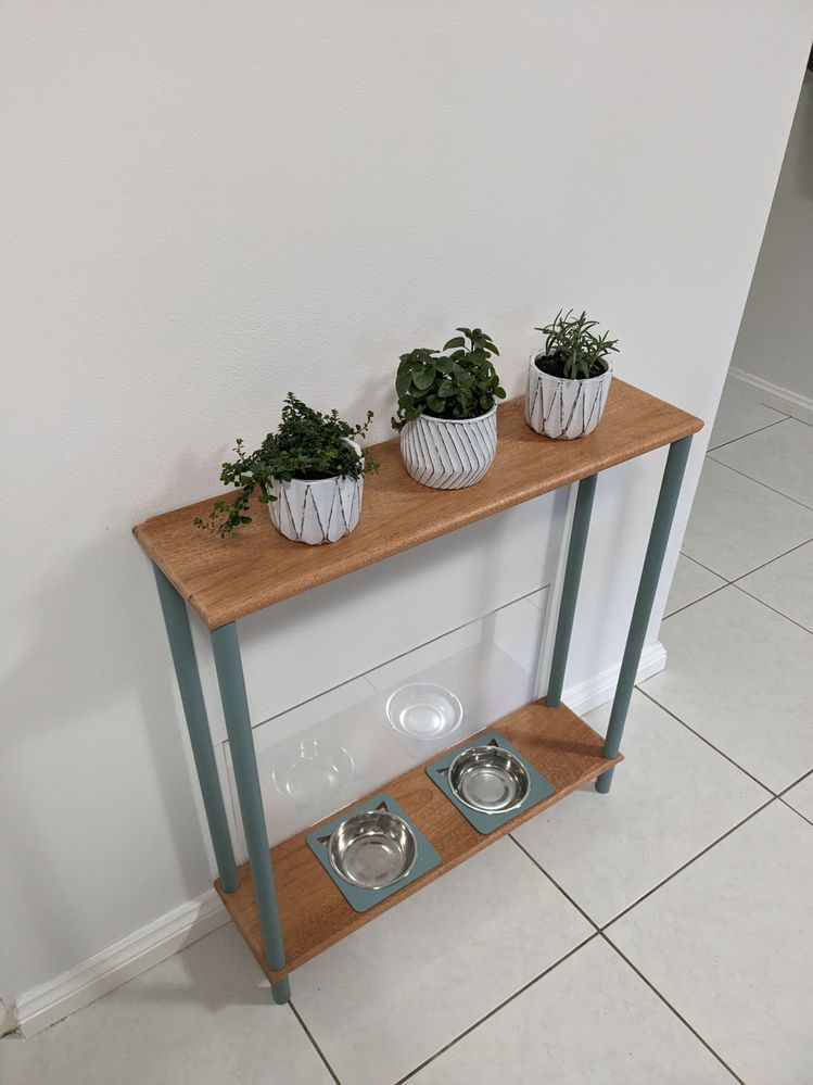

Since our cat is a messy eater and we wanted to avoid getting cat food on the wall, we decided to include a splashback. We cut a piece of 3mm clear pvc sheeting using a circular saw and attached it by screwing it to the back of the bottom shelf.
Step 6
To finish up, we painted the cat faces and legs in a fun shade of sage (Classic Calm by Dulux), and attached the top shelf to the wall using 3M adhesive hanging strips.
Step 7
To complete the look, we topped it off with cat--friendly kitchen herbs from the Bunnings garden selection - we chose basil, thyme and rosemary. We use one bowl for food and one bowl for water, keeping the mess off the floor and the wall. Dora the cat loves her new feeding station!
