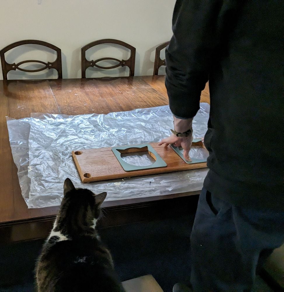

We wanted the bowl cutouts to have finger holes for easy feeding and cleaning, and thought doing them in the shape of cat ears would be super cute. We used a Ryobi jigsaw to cut a 130mm diameter for the bowls to sit in and little triangular ears for the finger holes.

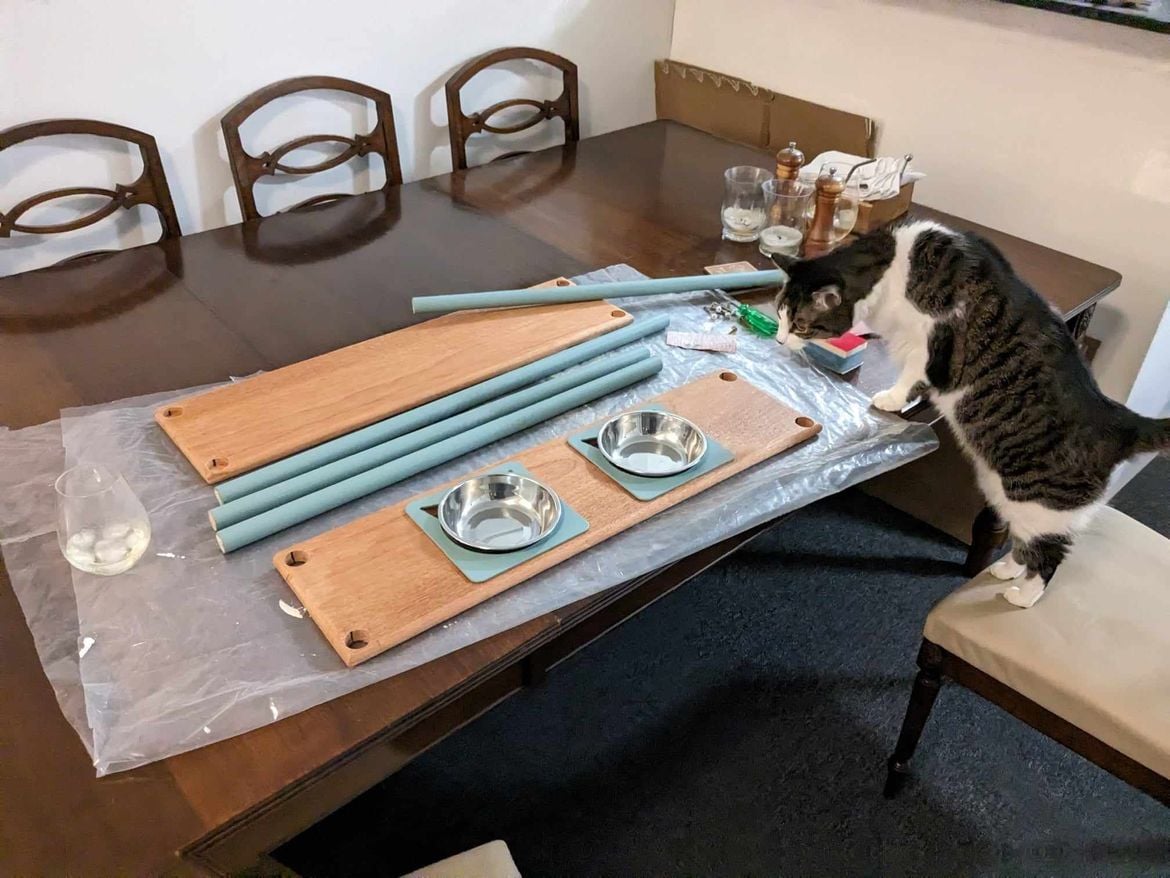

To attach the shelves to the legs, we used a 25.4mm forstner bit to drill pockets in the underside of the top shelf, and through holes in the bottom shelf. We pushed the dowels through to form legs and glued them in place using gorilla wood glue.

To finish up, we painted the cat faces and legs in a fun shade of sage (Classic Calm by Dulux), and attached the top shelf to the wall using 3M adhesive hanging strips.
