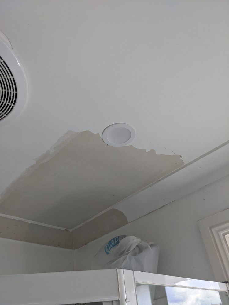

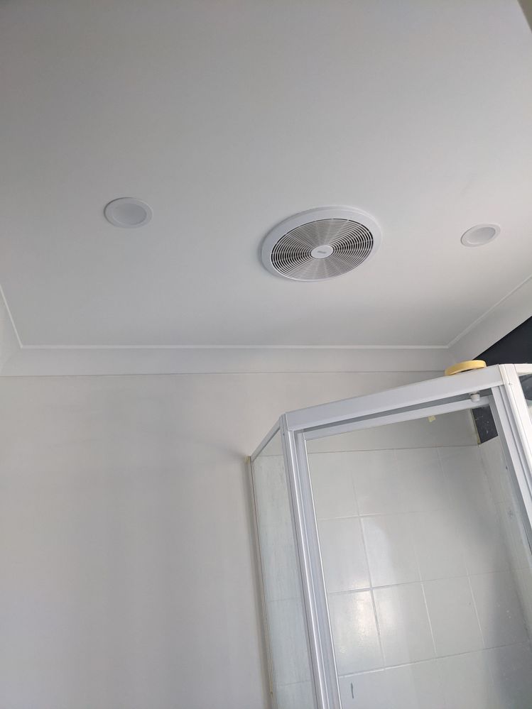

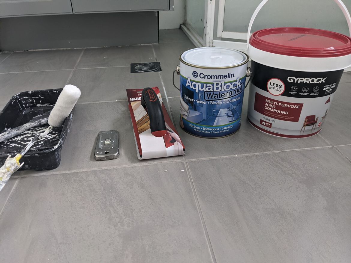

Just recently did my bathroom ceiling the paint was flaking off.
I scraped the whole paint off,  to bare board.
then I  use AquaBlocjk (Best thing I have ever discovered). Even any patched  with multi- purpose joint compound
Then I painted with Dulux wash and wear

Re: Ceiling paint flaking in kitchen
Great job @stelz, looks perfect.
Many thanks for sharing.
Thanks for your feedback on Crommelin AquaBlock @stelz. It's always great to hear from someone that has used it before, and it certainly sounds like you are very impressed with the results. Your ceiling looks amazing. Well done.
