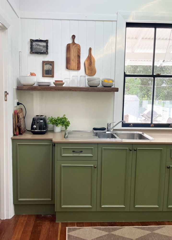

Apply two coats of Dulux Aquaenamel to both sides of doors.
Step 4
Apply chosen new Hardware and Style Space.
New Hardware applied and Space Styled
